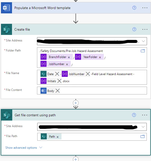

My flow stopped working about 2 weeks ago. After troubleshooting in anyway I can think of, I still can't get my form to pdf.
My flow is as follows:

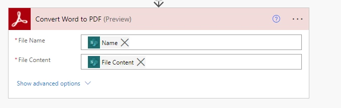

The error message after 8 tries is this:
I'm sure that I've just missed something, but I can't for the life of me figure out what I've done wrong.
I have other flows that are pdfing well with the same credentials.
