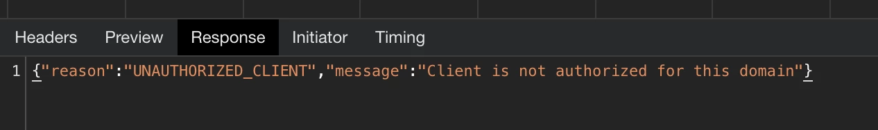

BUG - Cannot connect to Embed API with API Key
I activated the Embed API and, I think, I followed the instructions but it still not working.
When trying to access to the API with the key, I receive this:
This application domain (https://staging-ilha.herokuapp.com) is not authorized to use the provided PDF Embed API Client ID.

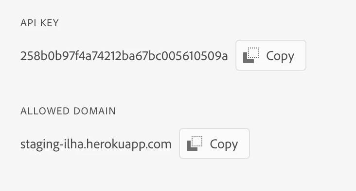

However, here is my setup:
I don't get what's going wrong 🙂
The error:
Thanks a lot !

    I haven't used React. Can you try the clientId with vanilla JS just to determine if it's the React code or a bad id?
    The problem is fixed.
    It was indeed a problem with the API KEY.
    I did enabled another API in the same project, so the API was requesting me to send a JWT.
    A created a separate project for this API and now it's working 🙂
    Thx for the help

    Nov 19, 2020 4:52 PM UTC
    Sorry, just realized that the error screenshot wasn't correct.
    Here is the good one. Sorry again
