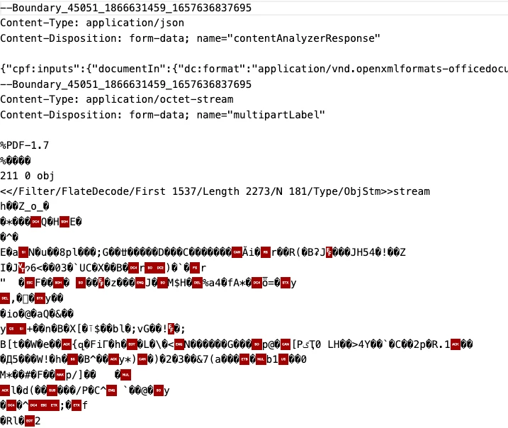

Ok - Now I see what's going on. The returned object is multipart form data, not PDF. The PDF is in the multipart form data. See image below. You'll need to parse the response to get the PDF.
