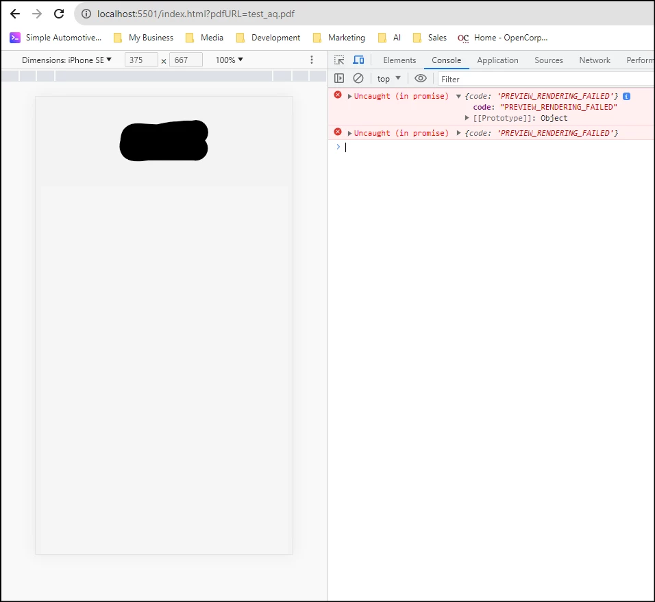

    Same here! We need a fix please.
    For my the issue only appears while I am toggling a device preview in chrome

    May 15, 2024 2:45 PM UTC
    Was having this issue and for me it was that we were initializing the PDF embed but not actually rendering the PDF on the page right away.  If the PDF wasn't rendered in 60sec then it would timeout and fire this error.  Refreshing and rendering the PDF would solve the issue.
    The fix for me was only calling the previewPDF logic when the PDF became visible/rendered on the page.  I'm sure you could also render it hidden (display:none) but I didn't test that out.
    Hope it helps!

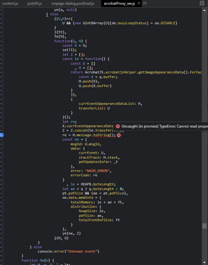

    Jul 25, 2023 2:32 PM UTC
    In my case, with google chrome, the problem became only with the console opened
