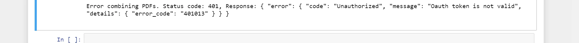

Jan 30, 2024 8:46 AM UTC
# Get access token (you may use your own method to obtain the token)
def get_access_token(client_id, client_secret):
    auth_url = 'https://ims-na1.adobelogin.com/ims/token/v1'
    headers = {'Content-Type': 'application/x-www-form-urlencoded'}
    data = {
        'client_id': client_id,
        'client_secret': client_secret,
        'grant_type': 'client_credentials',
        'scope':'openid AdobeID'
    response = requests.post(auth_url, headers=headers, data=data)
    return response.json().get('access_token', '')
# Combine PDFs using Adobe PDF Services API
def combine_pdfs(access_token, input_file1, input_file2, output_file):
    api_url = 'https://pdf-services.adobe.io/operation/combinepdf'
    headers = {
        'Content-Type': 'application/json',
        'Authorization': f'Bearer {access_token}'
    data = {
        "inputs": [
            {"url": f"file://{input_file1}"},
            {"url": f"file://{input_file2}"}
        "output": {"url": f"file://{output_file}"}
    response = requests.post(api_url, headers=headers, data=json.dumps(data))
    if response.status_code == 200:
        print(f"Combined PDF saved to: {output_file}")
    else:
        print(f"Error combining PDFs. Status code: {response.status_code}, Response: {response.text}")
# Get access token
token = get_access_token(client_id, client_secret)
# Combine PDFs
combine_pdfs(token, input_file1, input_file2, output_file)
Raymond Camden
Jan 30, 2024 3:01 PM UTC
You are missing the x-api-key header which should be your clientID value.
Also, files don't work that way for jobs. You need to upload them first and get the asset IDs, or use external files via the cloud storage systems we support.
