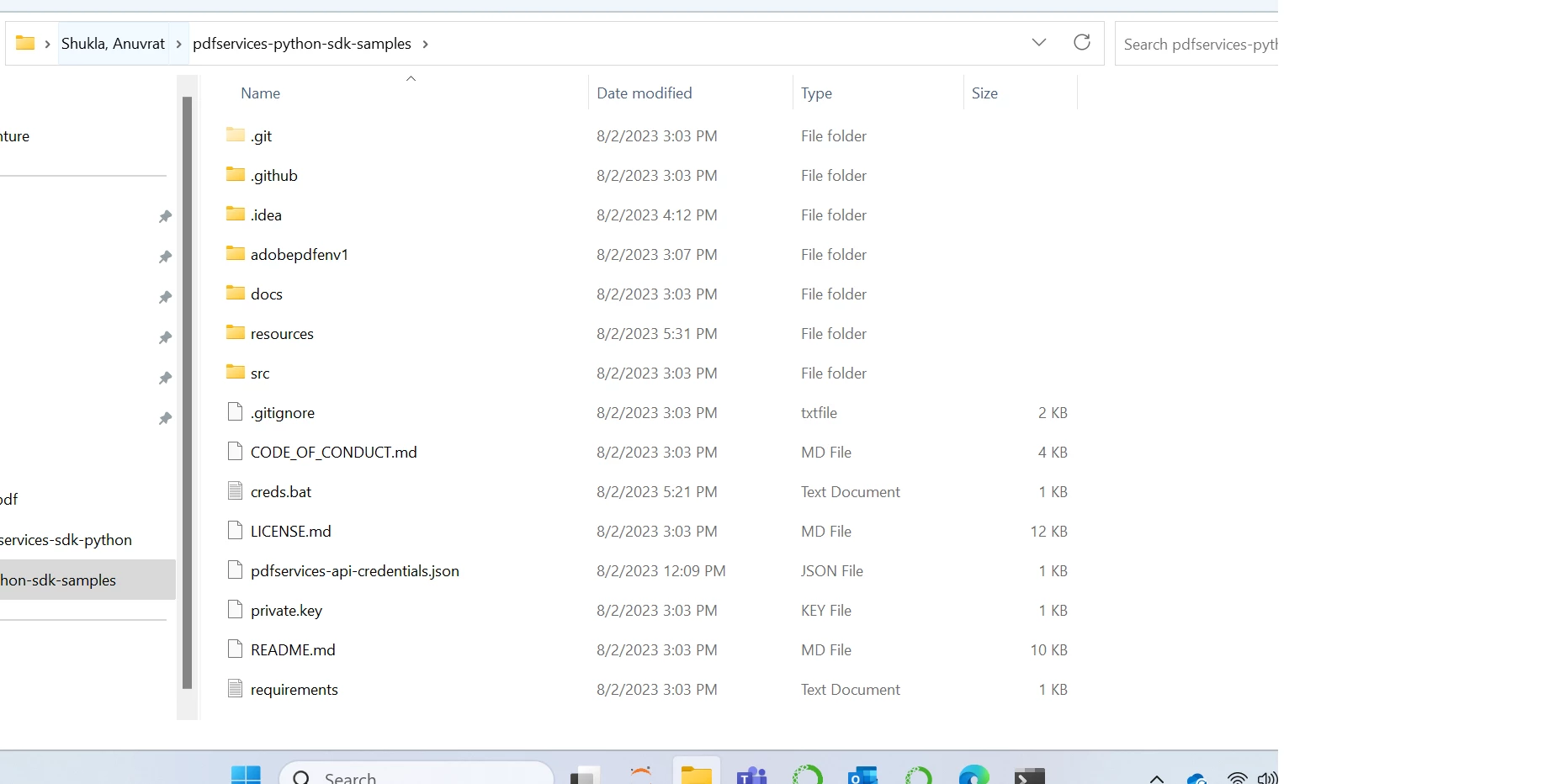

    Question 1:I wonder where is the input/sample pdf placed in the directory? Or should I have to place my pdf somewhere? I'm confused.

    The source is in the resources folder you should have in your download. If you don't see that, maybe copy from the zip again?
