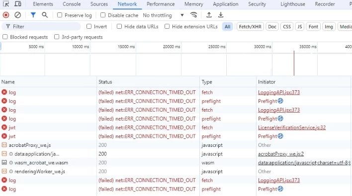

Hello, We are working on a project that uses the Adobe DC Viewer SDK. We have integrated the Adobe viewer in the application and installed the software, and also procured the ClientID key for the domain and applied. But we are getting an error with log and License Verification Service. Please see below error screen shot.

    That could be an ad blocker. Query, does the Embed actually work?
    Aug 20, 2024 1:23 PM UTC
    Yes, The embed actually works, we are able to view the pdf also, but after a few seconds (30 seconds approx) we get a message 'Application domain is not authorized to use the provided pdf embed api clientID', and when we check the network error in the browser we see the above issues in the screen shot.
