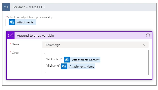

I have a Logic App that monitors incoming emails.  Some have multiple PDF attachments that I want to merge and save to Dropbox.  I have it working with the Encodian API but I want to switch it over to the Adobe API.
I then use the array as input for the Encodian API.  When I try this with the Adobe API, I get an error,
"bad value for parameter 'files'; invalid type".  Doing some reasearch I read somewhere that I should change the fileName line to
"$content-type": "application/pdf"
This still returns the same error.

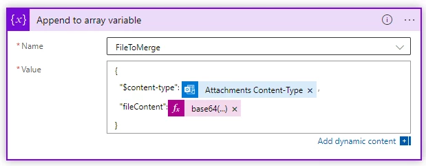

Even though the files were already PDF's I thought maybe they still needed to be converted to Base64 so I tried that.
The Append array action generates this result:
		"$content-type":"application/pdf",
		"fileContent":"SlZCRVJ..."
The error again is:

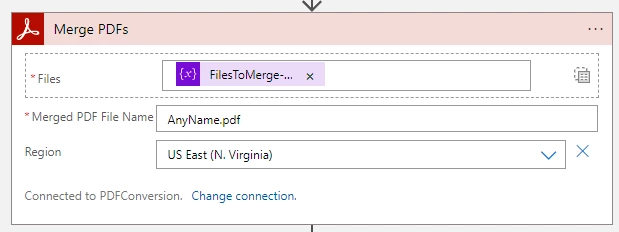

The Adobe Merge PDFs action then will look like this:
Be sure to click this button to change the input mode first:

Raymond Camden
May 28, 2024 1:27 PM UTC
You showed how you created the array, but not how you are calling the API. Are you using the official Acrobat Services connector?
DRYBSMT
DRYBSMTAuthor
May 28, 2024 1:48 PM UTC
Yes, I am using the official connector, thank you, I should have said that.  The code for the action is the last block of code in my question.
Raymond Camden
May 28, 2024 1:55 PM UTC
I don't use the code view often for PA, can you share a screenshot of the UI of the action?
