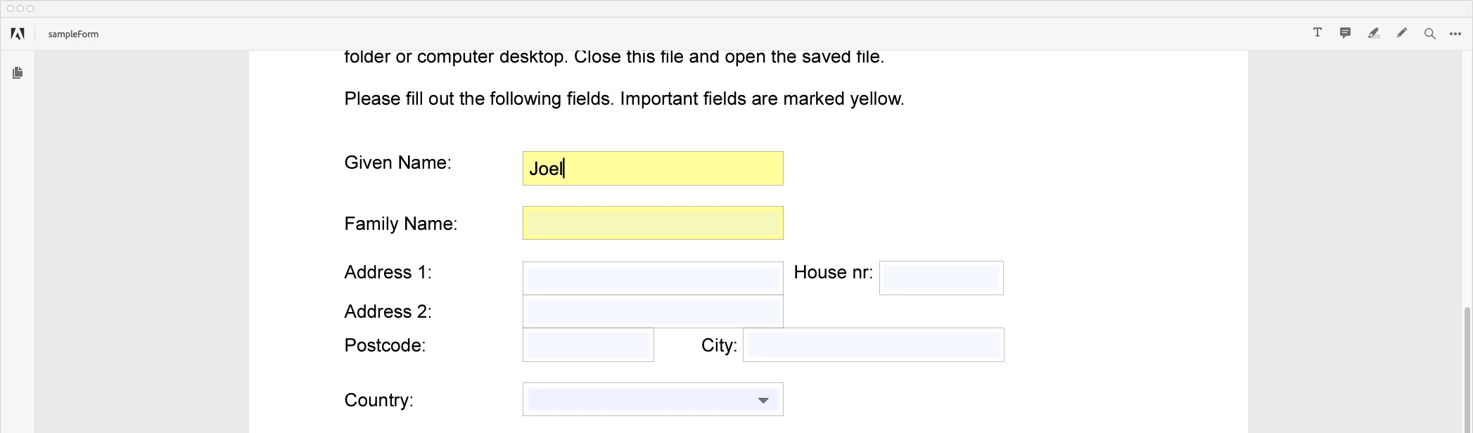

    The first file is secured and while the security settings should allow for form filling. I think Embed API is seeing the security and preventing form filling.
    The second file is fillable when I load it into the playground.
