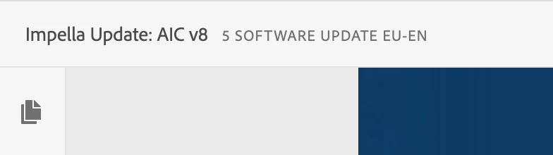

We have a PDF entitled
Impella Update: AIC v8.5 Software Update EU-EN
When displaying this PDF using the Embed API there are two issues:
1. The title is 'split' into two pieces which appears to be the main title and a subtitle. The split happens at the period
2. When downloading the PDF, the pdf extension is not included on the file. A user is still able to open it, but on Windows they are asked which app to use in order to open it.
Are there any workarounds or preferred ways of dealing with this?
Thank you

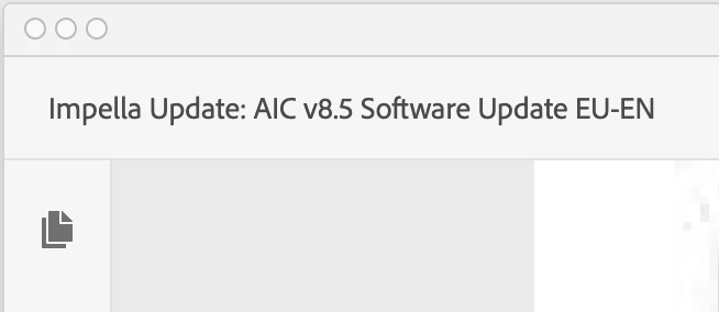

    Would it be possible for you to share the PDF in question? I tried renaming one of my PDFs to the given name but wasn't able to reproduce the issue.

    The filename of the actual pdf is not the one I gave. The url for the pdf is just a backend route that fetches the pdf. Perhaps the problem is when I set the 'displayName'. In the code below, meta.displayName = 'Impella Update: AIC v8.5 Software Update EU-EN'
        const previewFilePromise = this.adobeDCView.previewFile({
          /* Pass information on how to access the file */
          content: {
            /* Location of file where it is hosted */
            location: {
              url,
          /* Pass meta data of file */
          metaData: {
            fileName,
        }, { dockPageControls: false, showAnnotationTools: false, ...viewerConfig });

    Sep 3, 2021 7:14 PM UTC
    Meant to write 'metaData.fileName' not 'meta.displayName'.
