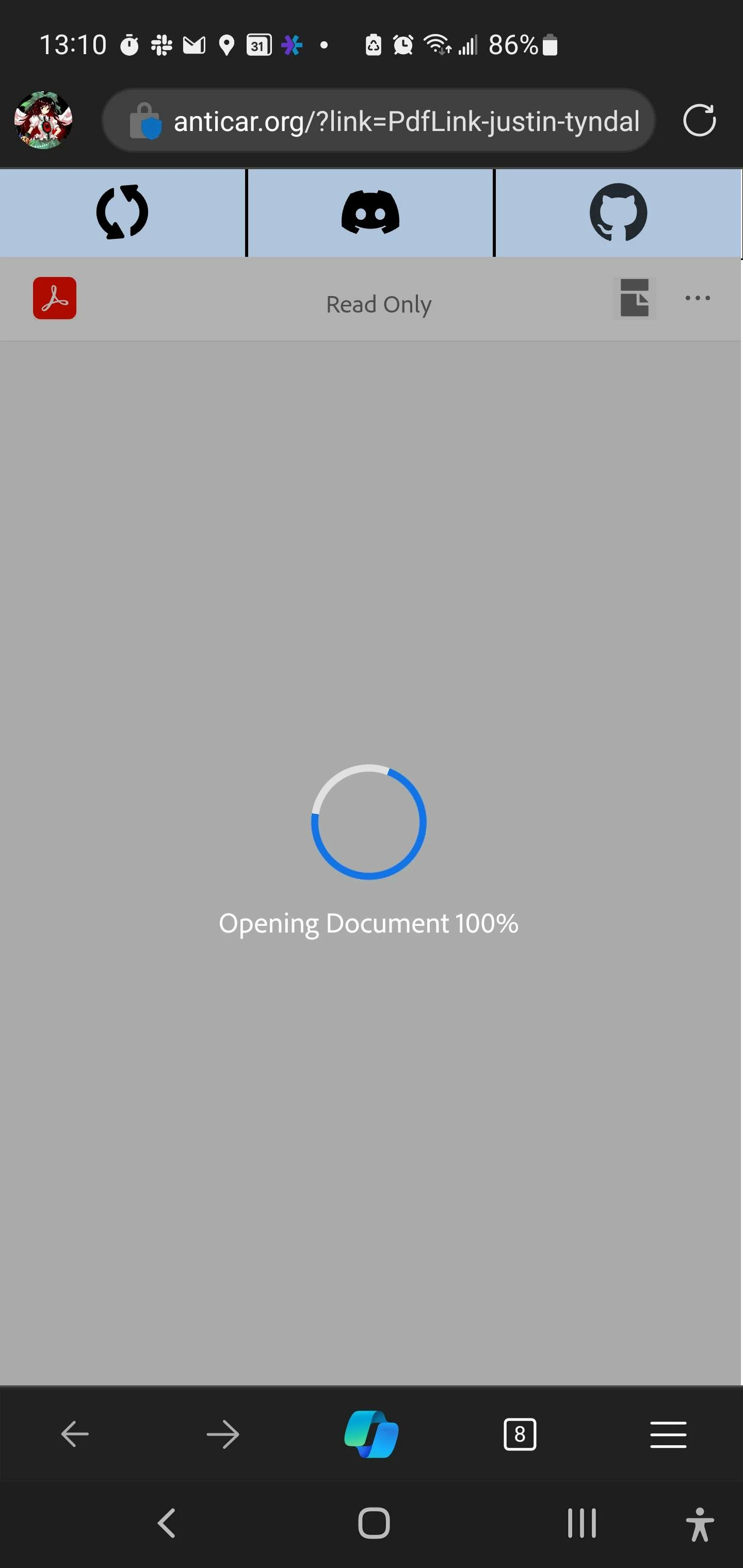

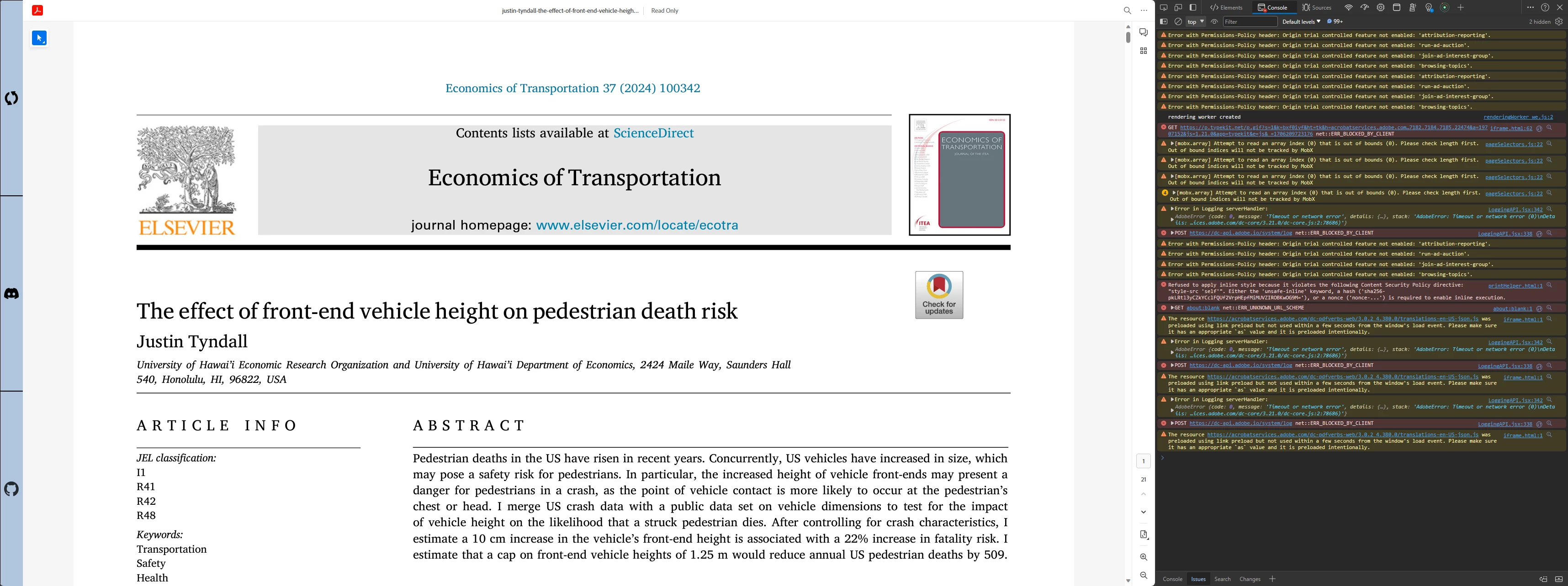

I am trying out the PDF Embed API. It has mostly been great, but I am encountering an issue of opening documents on mobile.
Attached are two screenshots, one from desktop which works perfectly. And on mobile (at least Android), which gets stuck on "Opening Document 100%" until eventually quitting.

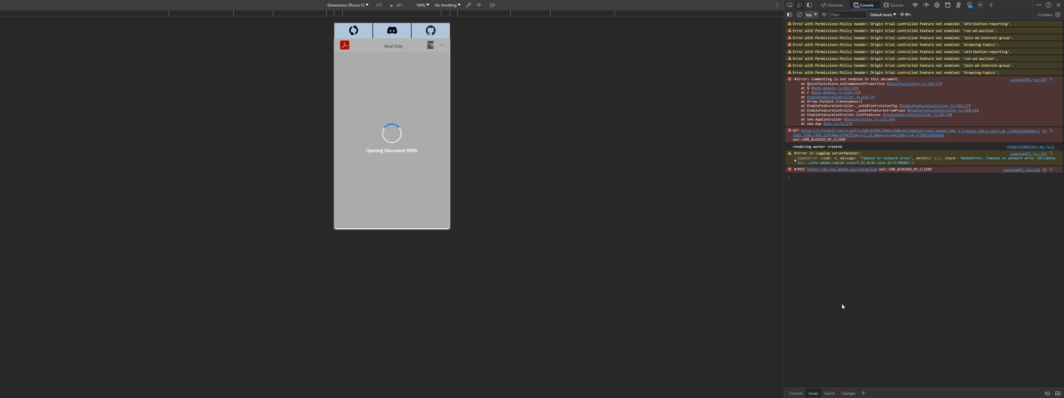

Something interesting I just discovered is that when I set the browser to emulate a mobile device I see a new error:
Commenting is not enabled in this document.
Is this because I have:
hasReadOnlyAccess: true
And if so, is that intended?
danthonywalkerAuthorCorrect answer
Jan 25, 2024 11:21 PM UTC
That indeed was the problem. So the solution is to either not have
 or, if you do, make sure you have
showAnnotationTools: false
For previewFile options (second parameter). Known working version:
TheAntiCarCollective.github.io/pages/modules/links.ts at 9e0a9082ecc62915858804890018a2ce89cc3f3a · TheAntiCarCollective/TheAntiCarCollective.github.io
