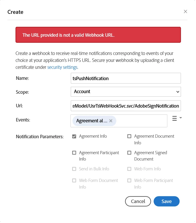

Error: The URL provided is not a valid Webhook URL.
I have contact support for this error and they keep asking me to contact Enterprise Team through call. I can't call them and I am using a Developer Account which I believe should not be a problem.
 Here's my code clearly setting the Header base on the ClientId,
[OperationContract]
			[WebInvoke(Method = "GET", RequestFormat = WebMessageFormat.Json, BodyStyle = WebMessageBodyStyle.Wrapped,
			ResponseFormat = WebMessageFormat.Json, UriTemplate = "AdobeSignNotification")]
			public string AdobeSignGetVerified()
				var currentWebOperationContext = WebOperationContext.Current;
				var outgoingResponseHeaders = currentWebOperationContext.OutgoingResponse.Headers;
				var incomingRequestOrigin = currentWebOperationContext.IncomingRequest.Headers["Origin"];
				outgoingResponseHeaders.Add("Access-Control-Allow-Origin", incomingRequestOrigin);
				var headerClientId = currentWebOperationContext.IncomingRequest.Headers["X-ADOBESIGN-CLIENTID"];
				if (headerClientId != null && headerClientId.ToString() == "CB*********************5q") {
					outgoingResponseHeaders = WebOperationContext.Current.OutgoingResponse.Headers;
					outgoingResponseHeaders.Add("X-AdobeSign-ClientId", headerClientId);
					var statusCode = WebOperationContext.Current.OutgoingResponse.StatusCode;
					statusCode = System.Net.HttpStatusCode.OK;
				return string.Empty;

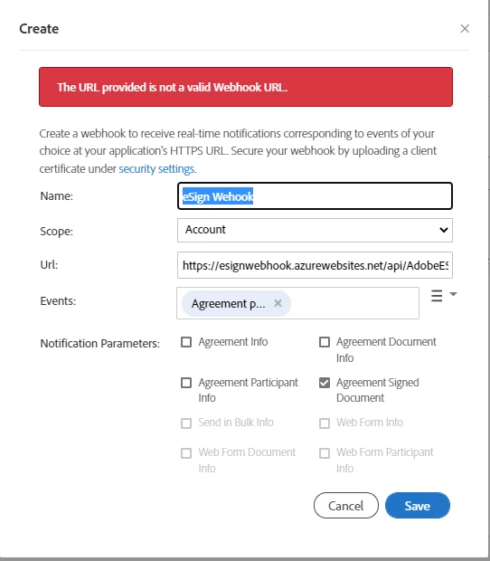

Dec 3, 2021 5:18 AM UTC
I have validate azure function webhook url and it's properly executed. but still shown error while creating ne w webhook.
MagentaSA
Dec 3, 2021 5:33 AM UTC
Just check the webhook you created it cannot be created using them:
  • SiteLocalAddress
  • LoopbackAddress
  • LinkLocalAddress
  • AnyLocalAddress
  • MulticastAddress
Perhaps this link can be of assistance.
https://www.adobe.io/apis/documentcloud/sign/docs.html#!adobedocs/adobe-sign/master/webhooks.md
https://helpx.adobe.com/sign/using/adobe-sign-webhooks-api.html

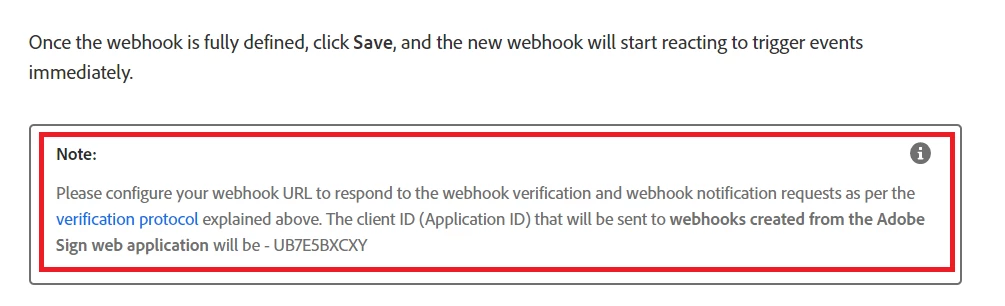

Jimmity Jamst
May 16, 2022 1:24 PM UTC
Hi Solem,
I had the same issue. I've now followed the instructions for verification, having read your post, but I'm still getting the error: 'The URL provided is not a valid Webhook URL'. When I hit my webhook from Postman, I am seeing the correct client ID in the response for the header 'X-AdobeSign-ClientId'. Before I log a case with support, do you have any thoughts on what else may be wrong in my case?
Thank you.
May 17, 2022 4:09 PM UTC
Hi Jim,
I hope you have fixed your problem. If not just double check the URL you are pointing to.
Regards.
