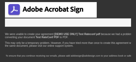

I have Issues With Creating An agreement from a transientdocument which is a PDF uploaded through the api. To upload the file, this is my current code implementation:

With the above i'm able to get the transientDocuments ID but not when i uncomment the 'Content-Type' in the header. After doing this, when i try to create an agreement from the transientDocumentsID, i always get a "<Response [404]>
{"code":"NOT_FOUND","message":"Resource not found"}". And whenever i try to use other endpoints of the agreement with the transientDocumentID, i later always get a mail from adobe attached as well. Have tried using a different pdf file incase its the cause of the issue but its still the same behavior. However, when i upload the pdf through the dashboard, i don't experience any issues. How can i have this solved? Thanks in advance.

Hi There.
According to youranswer in Transient Document uploaded Programmatically is Al... - Adobe Support Community - 13747215 I believe the issue here was the file mimie type.
Please mark as answered if you get a chance?
