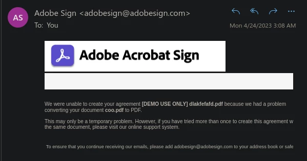

Whenever i upload a pdf document to the transientDocument endpoint, i always get a transientDocumentID and i'm also able to use it to create an agreement but whenever i try to add fields to the agreement, i get a message "The Agreement is not in Authoring Mode". When i check the status of the file, it shows that the agreement is Cancelled and then i get a mail from adobe:
Have changed the pdf being uploaded to test if its an issue with the document but its not, the same thing happens for every pdf document i upload. But whenever i use the adobe sign api rest v6 page to upload the same pdf files, i don't get any errors and it works. This is my code for uploading the document:

I was later able to get it to work even though it took somedays. The issue was i had to set a mime-type in the files just like you did in the python example you provided so i ended up with something like this to get it to work:
