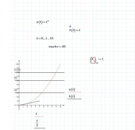

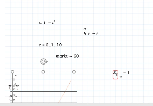

I have Adobe Acrobat Pro DC on my home computer and also at work.  I have tried numerous times to export PDF files to Powerpoint using the Export function and I get results that range from a few characters missing or misplaced on the page to a page of complete gibberish.  A page of completely plain text with no special characters or graphics seems to work.  Anything beyond that is not working.
Enclosed are screenshots of a pdf and the resulting pptx that has the parentheses missing in several places.
