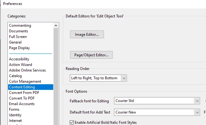

Feb 1, 2023 2:23 AM UTC
I found I had to click the A|B in the top right after inserting text to have it change to fixed width.
It then changes to |Ab to signify you can change back to nonfixed width
Im not sure if it was necessary but before I saw this I clicked Edit --> preferences --> Font Options , and changed both default and fall back to courier which is fixed width ... this helped me fill in forms with fixed boxes for each character.

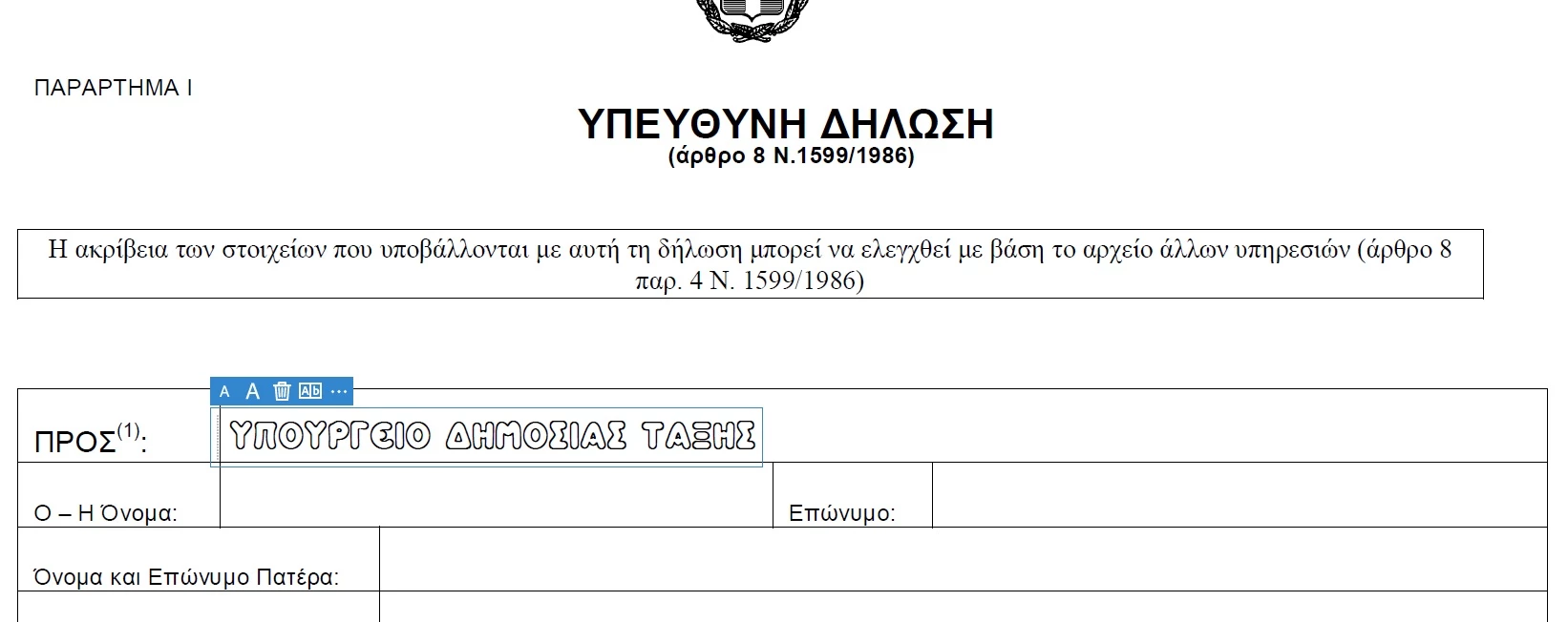

Nov 11, 2019 10:23 AM UTC
Hello, I wanted to add a text on a pdf file and the font is changed to a font
that I latelty download (greek font).
So now i am trying to fill a form and uses that funny font that i downloaded.
If it change by itself shouldn't be a way to change it back?
It is so furstrating 😞
May 3, 2022 1:38 PM UTC
Hello.
Have the same problem.
Did you fix it?
Baruch
