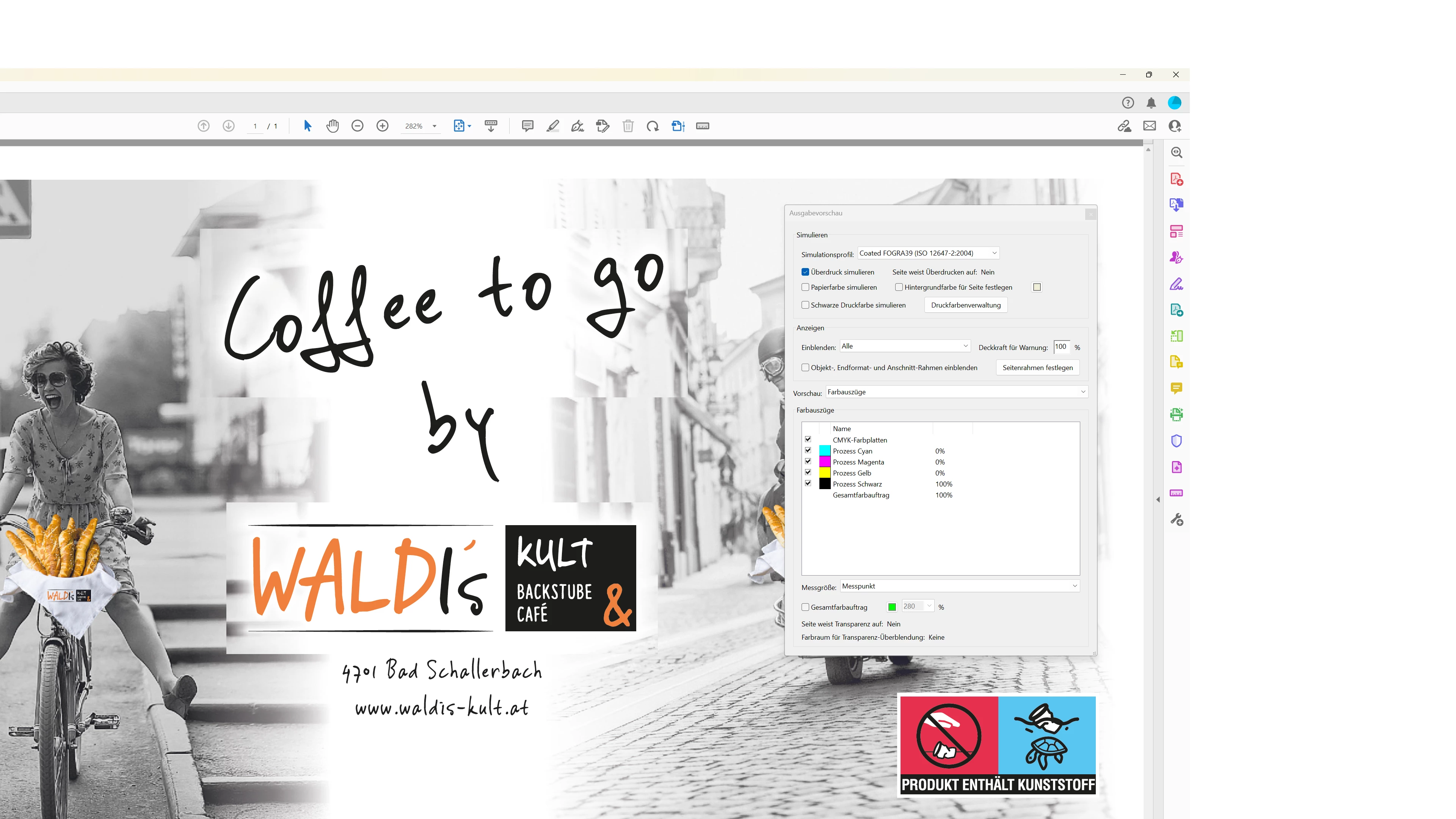

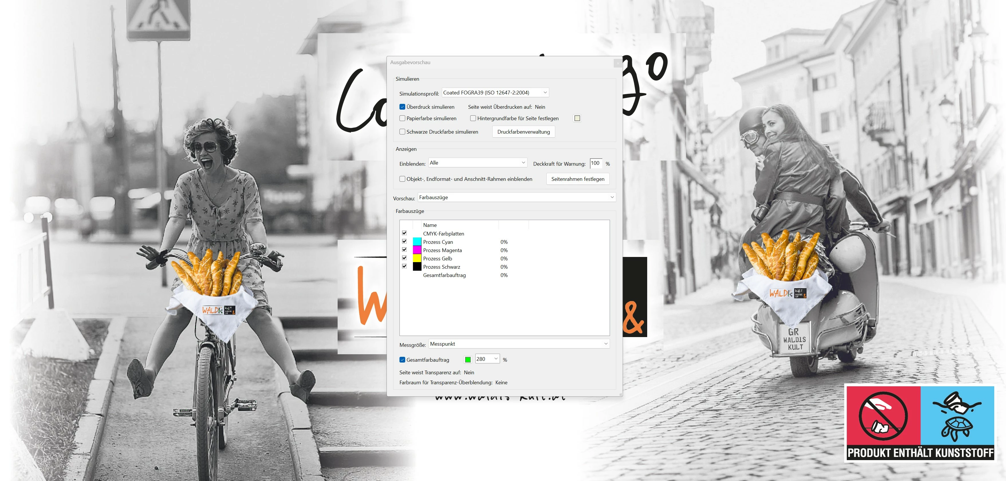

I have a very specific problem with my printfiles. The printing house needs the colour with a max. ink coverage of 280%. So I reduced it in the pictures and saved my pdf. Everything seems correct when I open and controll it with Acrobat, but when it is opened with another computer the colour values are totally messed up and the black isn't build up with 100% black, but with all CMYK colours. For that - the maximum ink coverage is to much for printing again ...
It also occured to me, that sometimes when I open the file this wrong colour scheme is seen on my application too. But when I close it, and restart, or wait for a few minutes its allright again, as I have saved it ...
Is this a bug, or did I make a mess with the settings when I saved my file? (Test file attached. The black text
is set to be 100% black, the picture in CMYK)

My Colleague and I use Adobe Acrobat Pro (64-bit) and the colleagues in the other department have the standard Adobe Reader. We don't use any other Pdf-Readers. The real problem is that my file does not use the colourscheme I want when I upload it to the printhouse. I tried and dissembled all colourmanagment, so it uses the colours as I have build them up in Illustrator and photoshop, but it still doesn't work as I want. I'm out of ideas what to do now.
Maybe you have some input, that would be great.
Best regards
Barbara
