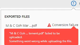

Trying to convert to DOCX using the subscribed ExportPDF feature...
Acrobat Reader keeps saying the upload fails after about 10% of the progress circle is complete.
I can upload manually and convert but this is not a fix, we need it to work as intended for the End Users.
Have tried removing, rebooting and re-installing - No change
Have tried downgrading to an older version - No change
Have upgraded to the latest version available from the site right now - No change
Have deleted the local cache files in Appdata for Reader - No change
Have cleaned up the appdata folders between installs of different versions - No change
Have tested under another user profile - No change
Have tested with administrative rights to the PC - No change
Only affecting 3 out of 25 computers and all affected at the same time with no apparent reason.

Focusing on just one of the machines, I have tried:
Updating to the latest Acrobat Reader version available 18.011.20038.5321 - no change
Cleaning Adobe off using the suggested tool, rebooting and re-installing the recommended version as above - no change
Tested with 10 different PDF's ranging from simple 1 page to 40+ page documents - no change
Adding a WiFi adapter to the desktop and connected to an isolated test wifi network - no change
Exited all anti virus and security software on the machine - no change
The error is always the exact same as the original screen shot.
Is there any other avenue for support, I suspect a developer would know the answer straight away, it possibly relates to the way the file is cached to the local machine before upload?

We apologize for the inconvenience caused, as per the description above, you are not able to upload a PDF file using Adobe Reader DC so that you can convert the PDF to a Word document using the Adobe ExportPDF service, Is that correct?
The record shows that you are subscribed to Adobe ExportPDF service with your current Adobe ID, try exporting the PDF file through the URL https://cloud.acrobat.com/exportpdf with your Adobe ID and password on a browser like Chrome, or Firefox, or Safari and see if this brings any difference.
The latest update of Adobe Reader is 18.011.20038, please check for the latest updates from help>check for updates, reboot the machine after installing the updates.
You can also install the latest updates manually from DC Release Notes — Release Notes for Acrobat DC Products
You can remove Adobe Reader using the Acrobat cleaner tool Download Adobe Reader and Acrobat Cleaner Tool - Adobe Labs
Reboot the machine and install the latest Adobe Reader DC from Adobe - Adobe Acrobat Reader DC Distribution
If the issue still persists, please try connecting the machine to a different network environment like a wired/wireless guest network or a mobile hotspot.
Is the conversion failure/upload issue is specific to one PDF file or is it with all the PDF file? Have you tried with other PDF files?

Hello Naomig,
Sorry for the delayed response and inconvenience caused. There was a minor issue with the Document Cloud conversion with a browser and that has been taken care of.
Please try converting the file through a browser like Chrome or Firefox or Safari https://cloud.acrobat.com/exportpdf
We would highly appreciate your help in getting this issue fixed, as this issue is not reproducible at our end in any environment , however, with the details shared by users, we are trying to get this issue resolved.
If you are still experiencing this issue with the Adobe Reader app, please share the following details:
