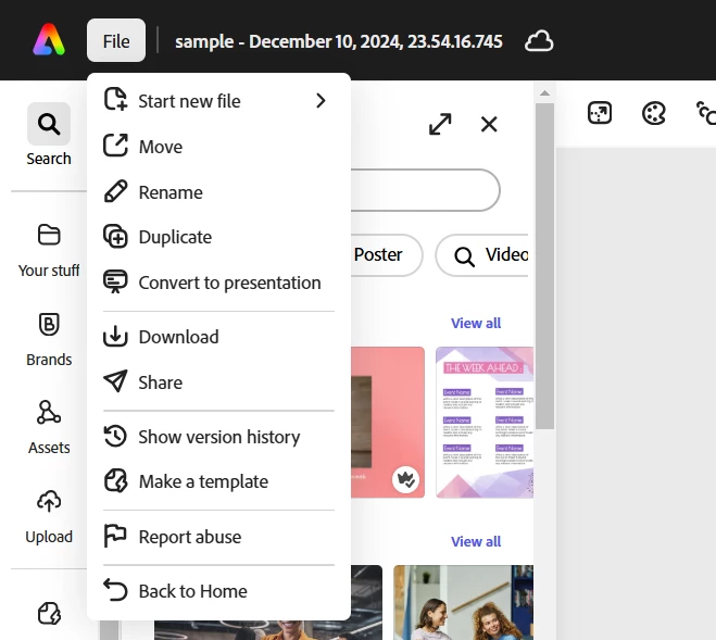

Hi @Justine Lu0D4C,
You can convert a file into a presentation by opening the Indesign file into Adobe Express and clicking on the file and following the options-
Tarun
