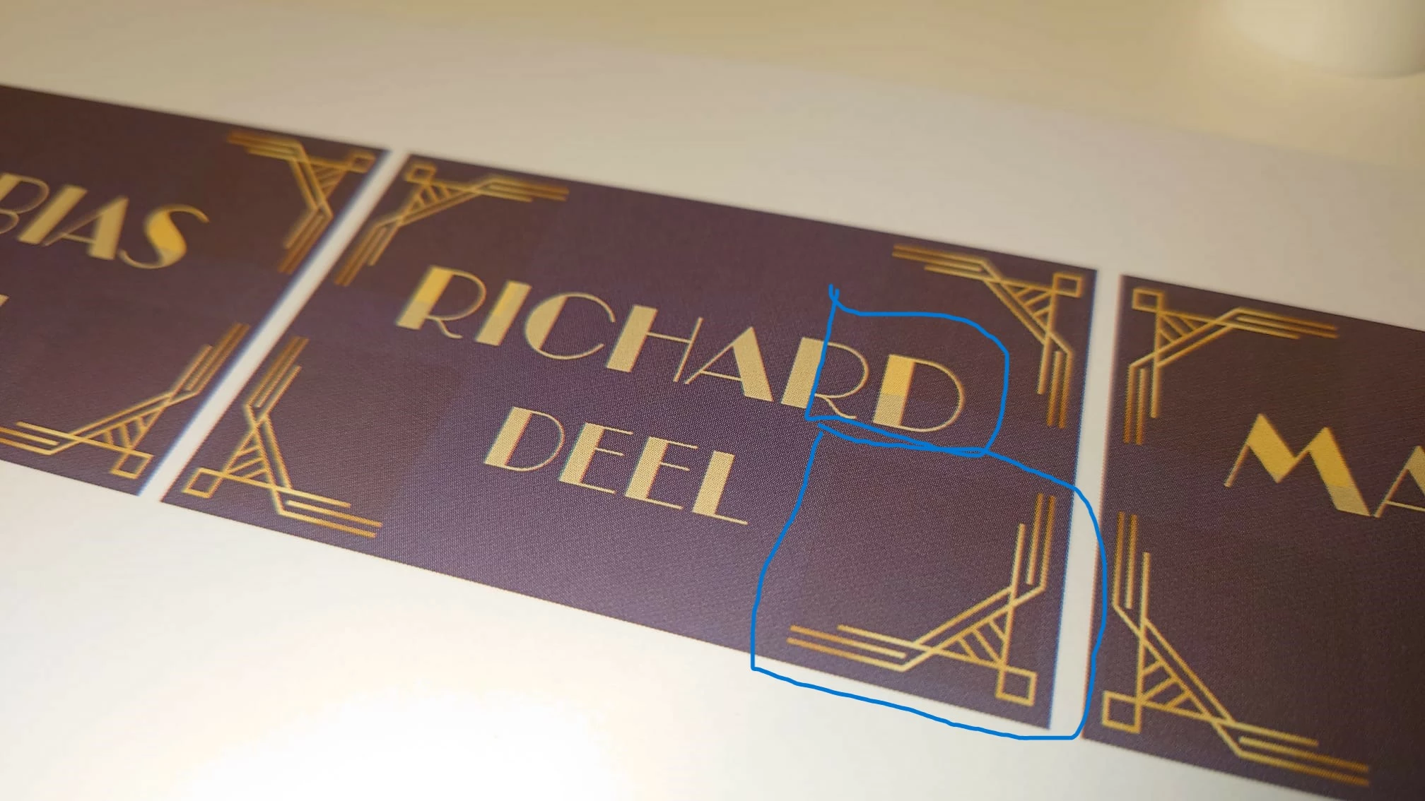

Hello forum,
I have an issue with a design I've created.
I used adobe express ai to create a style that looks like Great Gatsby, all fine and dandy, very happy with the design, it looks perfect on the screen.

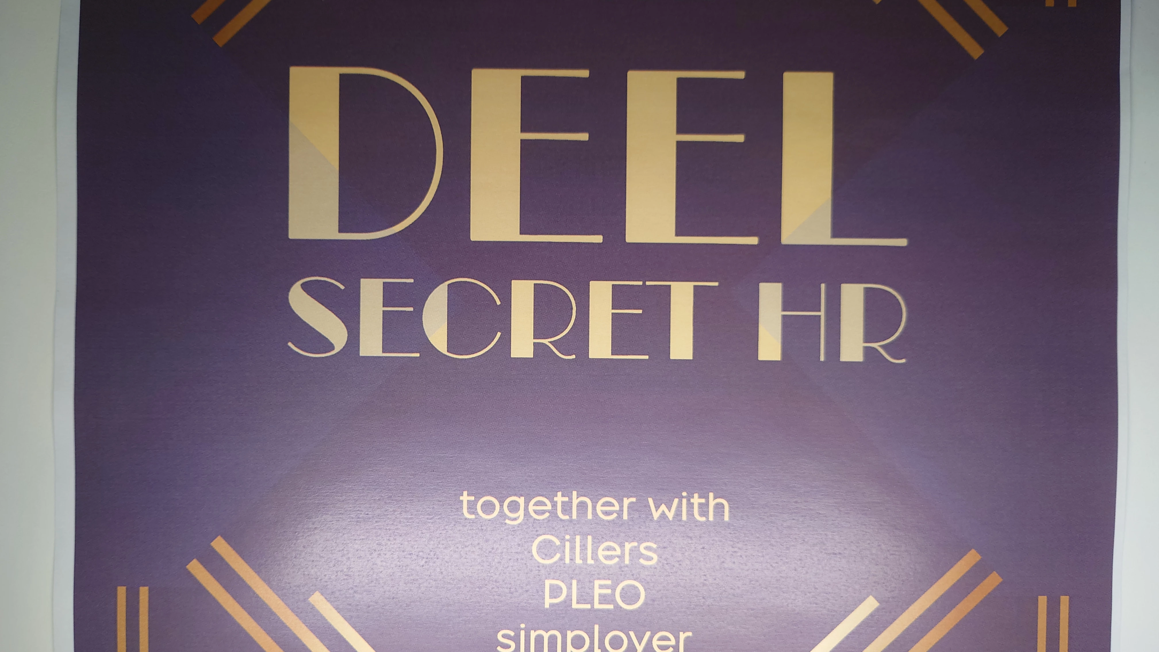

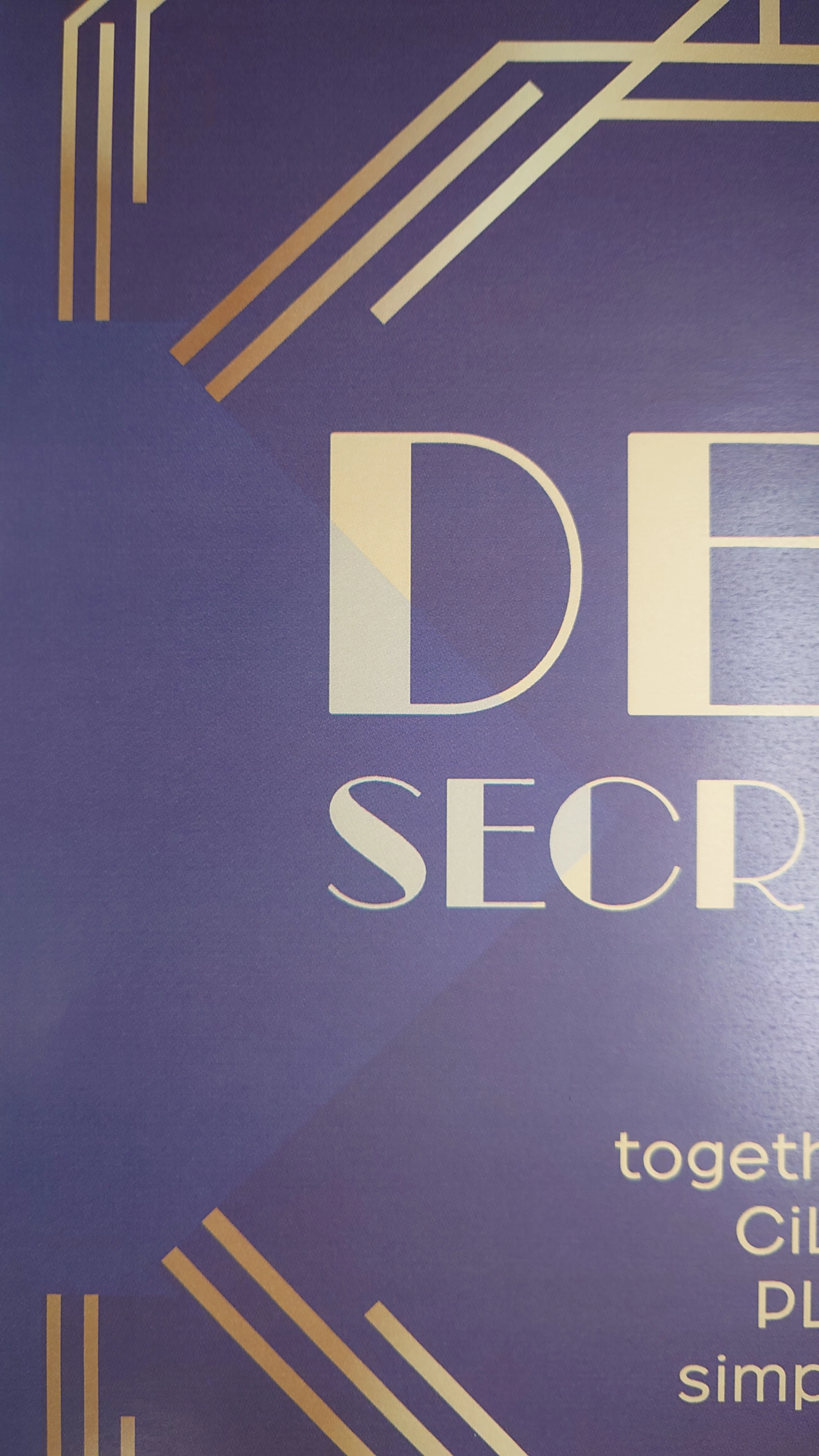

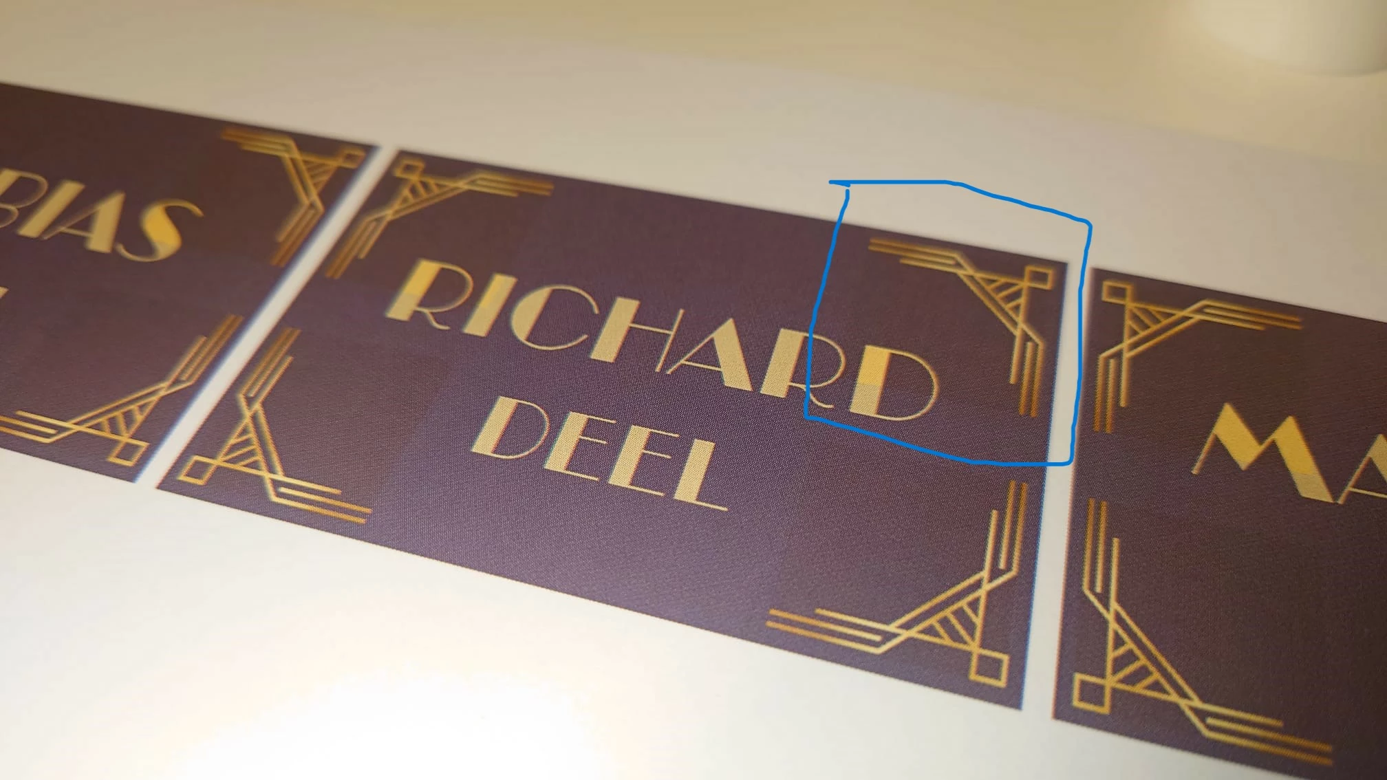

However, printing a downloaded pdf reveals some sort of opacity layer that should be flattened before printing. This creates an unwanted effect on the print where there are colour differences visible. Both the background colour and the text is affected. See attached picture.
Following the lines to me it is obvious that they are somehow connected to the graphical elements present in this design, and I may very well have made an error in creating the file. But to try and blame it on printer error isn't going to work since the pngs print fine. The error is somewhere in the file..
I've tried both the pdf export options. I've tried exporting as single file. I've tried exporting all pages as one pdf. All show the same problem.
It does work to save as a PNG and then print.
I'm just a really curious type and want to know why it doesn't work.
I've been on a chat with support, and they weren't able to figure it out. Suggestions was to download a pdf- open in chrome- print as a pdf- open acrobat - print as a pdf. It didn't solve it, the problem was still there.
Thanks in advance, Adobe you're welcome to contact me if you need more info.
I'm on adobe CC all programs 100 gb, file created online, printer is a nashuatec imc2000.

SebbanDCorrect answer
December 3, 2024
This worked! Blend Mode set to normal changed the game! PDFs prints the way they should now.

Found the blend mode setting, quite a few of them were set to Pass Through, I'll try normal and see if that works.

SebbanD
SebbanDAuthor
November 27, 2024
Hi Amitej,
I agree it shouldn't happen.
And no, it is not present in PNGs. The effect is only visible in PDFs, as stated in OP.
How do I control blending modes in adobe express?
Sebastian
Amitej S
November 25, 2024
Hey @SebbanD, This shouldn't be happening. If you're getting these effects in the downloaded file, be it a PDF, JPG, or PNG, then the effect is present in the project. You may want to check the blend modes and the effects of the layer showing up. You can also try changing the position of the layer and then try printing.
Do share your observations with us.
