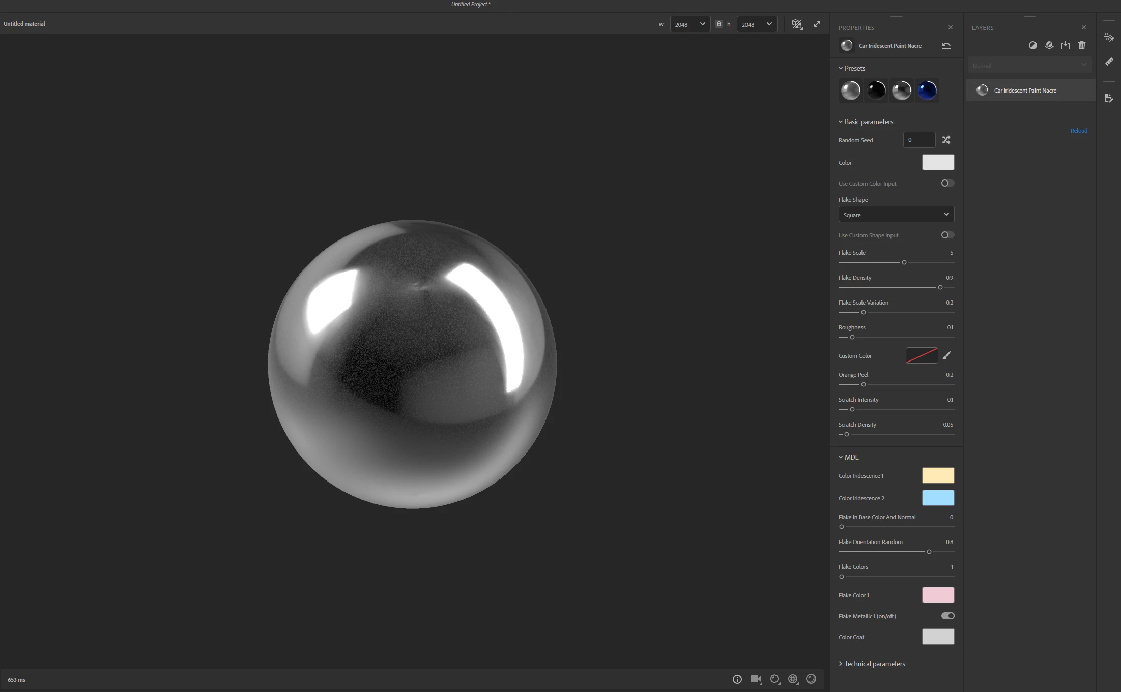

I don´t know if this is a bug or just me not being able to find the solution. When using this Substance:
https://substance3d.adobe.com/assets/allassets/f2e7ab95ef0f2bcbbf569cbfe56c28bd59221a94?q=Iridescent&u=Iridescent
It doesn´t display properly. I´ve tried both in Adobe Sampler and Autodesk VRED, nothing is working (see screenshot attached), it doesn´t show the flakes and iridescence correctly. No matter which settings, environment or parameters, i coulnd´t achieve a look similar to the preview of the substance.
Does anyone have an idea?
I´m running the latest versions and drivers for everything.

The MDL file that should be attached to this asset as an additional download is missing, we are looking into it!
The mdl file on top of the regular sbsar/sbs material allows to have a clear coat.
However even with this MDL file you will have to use it in Substance Designer with the IRay render to have the same look as the render on the platform, or use another software which handles MDL files. I don't think it is that common anymore
