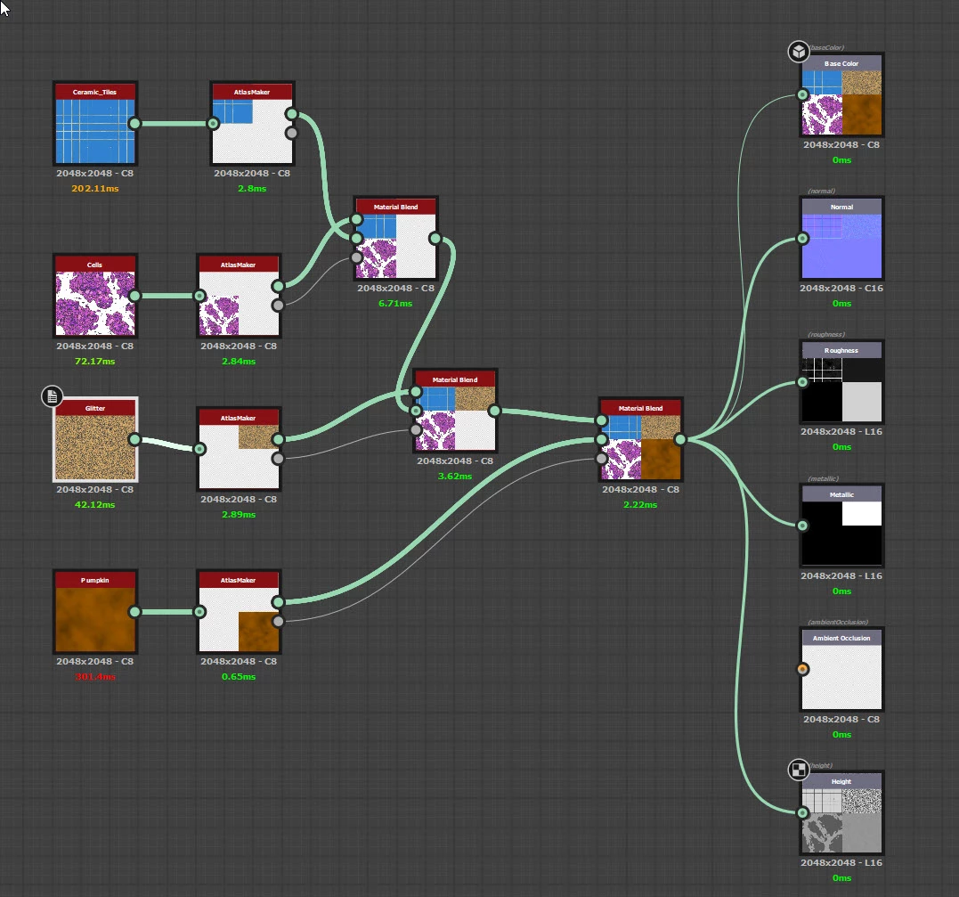

The easy way I've found to do this is with a Material Transform node and then a Material Blend node, not the most elegent solution in the world but it works!

You can do it with material blend and masks.
Wes McDermott from the Substance team created a series of videos a while ago on Atlas creation as well as an "Atlas Maker" node, which has controls over masking and material tiling.
The videos are here: https://forum.substance3d.com/index.php?topic=5840.0
Note the links to download the node have expired but if you scroll down the conversation you will see that Wes added a zip file in his third post. It will update on opening to the latest version of Designer but does work.
Quick demo using Wes' node to create a simple Atlas from four materials - but the node is not limited to that number or to square materials and makes setting up the individual materials and masks very quick.
