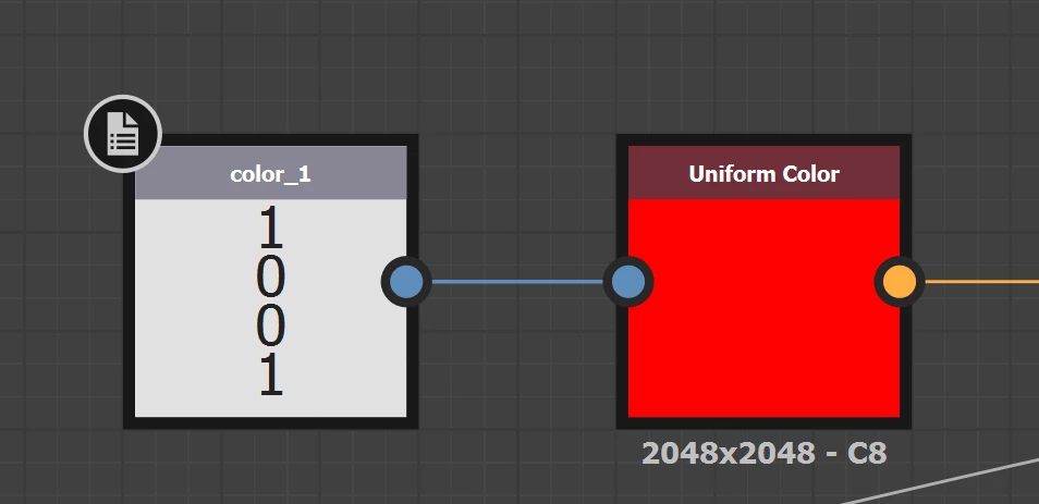

for color the easiest way to do it is create a float 4 input and hook that up to a standard color node then you can just pass the float values to that and use the color node line normal in the graph

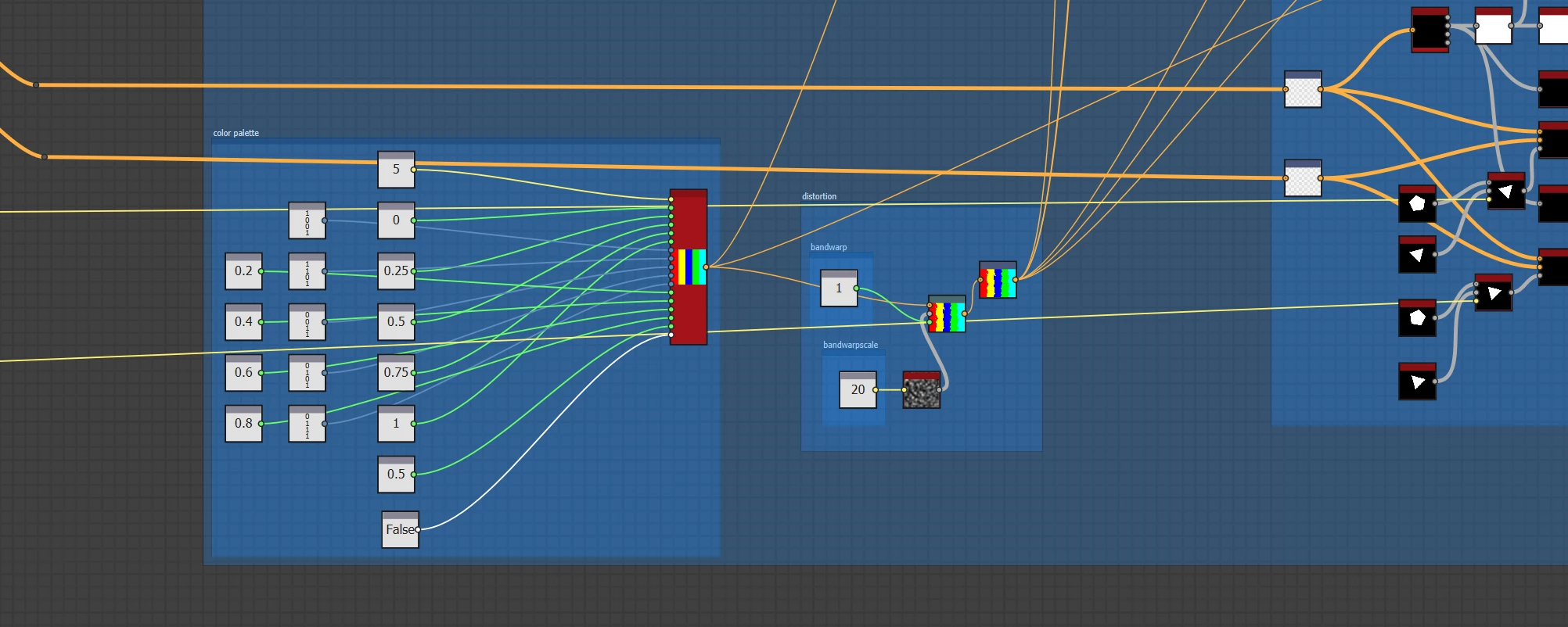

example of what I mean by breaking out the inputs, as your graphs get more complicated it becomes really hard to track.
