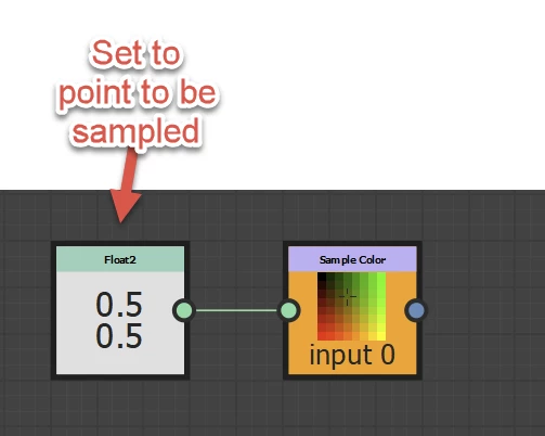

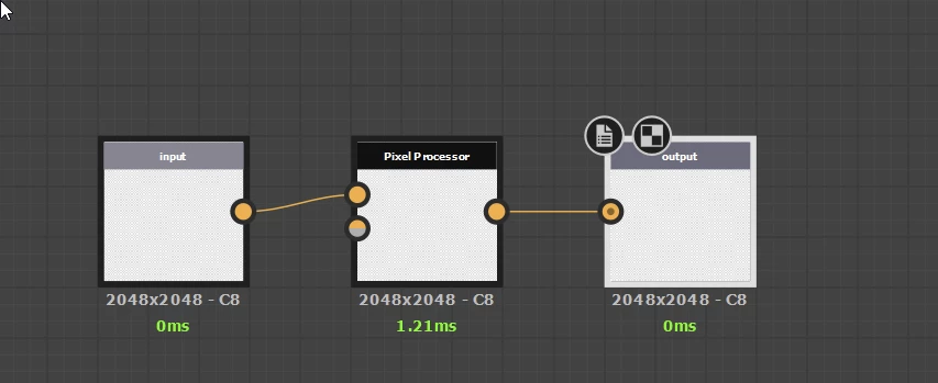

I'm interested in how you will use a material triggered to update in a loop for presumably for  a video.
Sampling a point colour is very easy using a pixel processor function with a sample node.
So to read an input bitmap at a specified point and output a single colour based on that point
The pixel processor function is very simple :
However that relies on it reading an input bitmap not a moving image. Using such a material in a continuous moving way i.e. updating the input bitmap x times per second is not the way Substance Designer was created so you would need to work out how to do that outside of Designer
