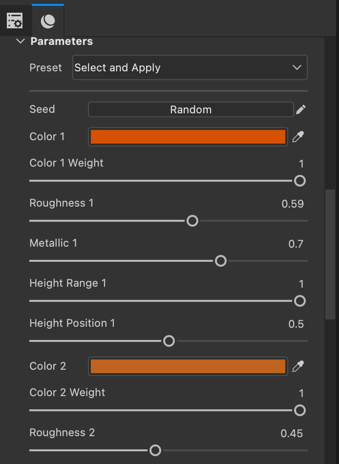

Scanned materials have parameters for roughness, metalness, height, etc. and you often have two or three values regarding the Base Color.
They are not procedural, but you can make them a bit more unique.

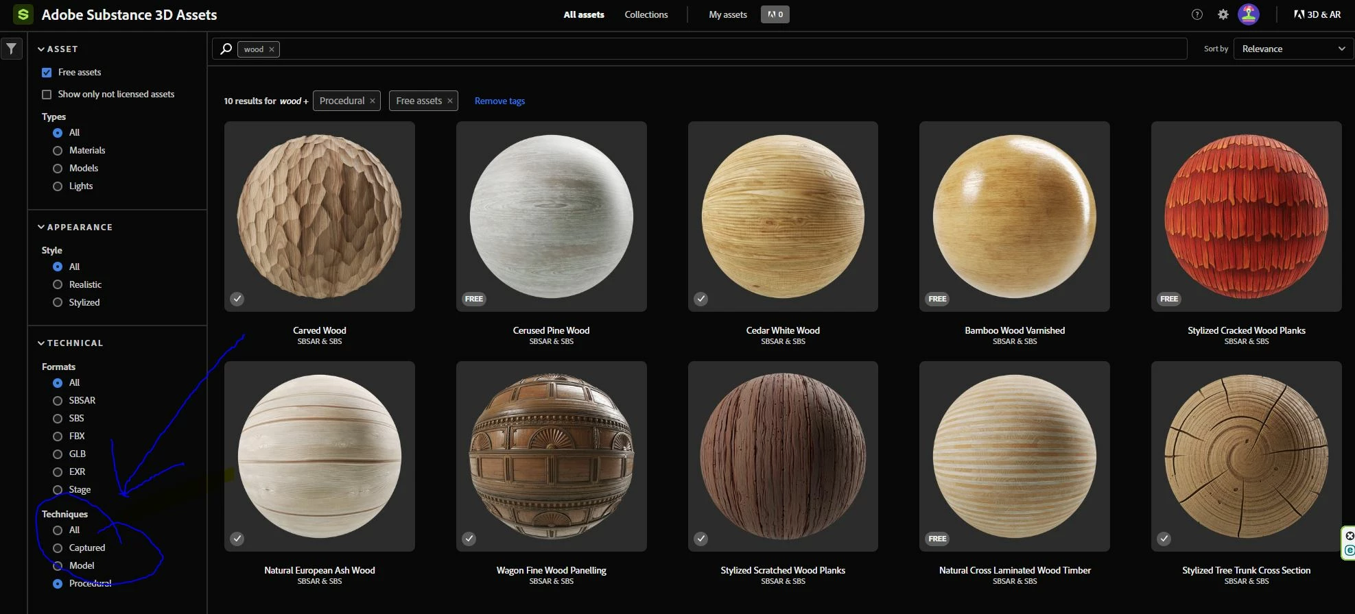

"I'm not exactly sure what you're referring to when mentioning Captured assets, but I guess this is scanned material." On the Adobe Substance 3d Assets search page (see image attached) bottom left you have 4 Techniques:
All
Captured
Model
Procedural
It is the Captured option filter that I am wondering about.  Does choosing materials generated by the Captured technique give you the "old-fashioned" non-procedural materials that use a texture map to generate the look of the material?
