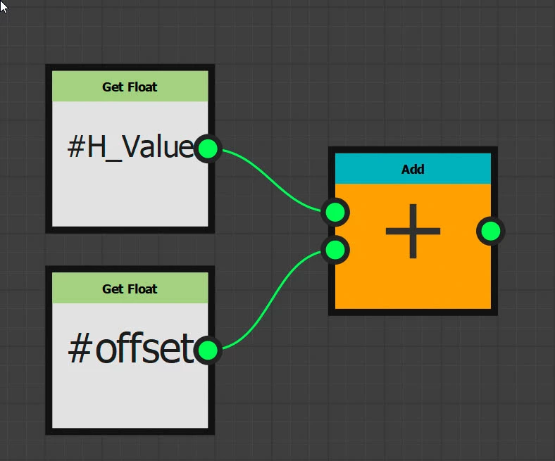

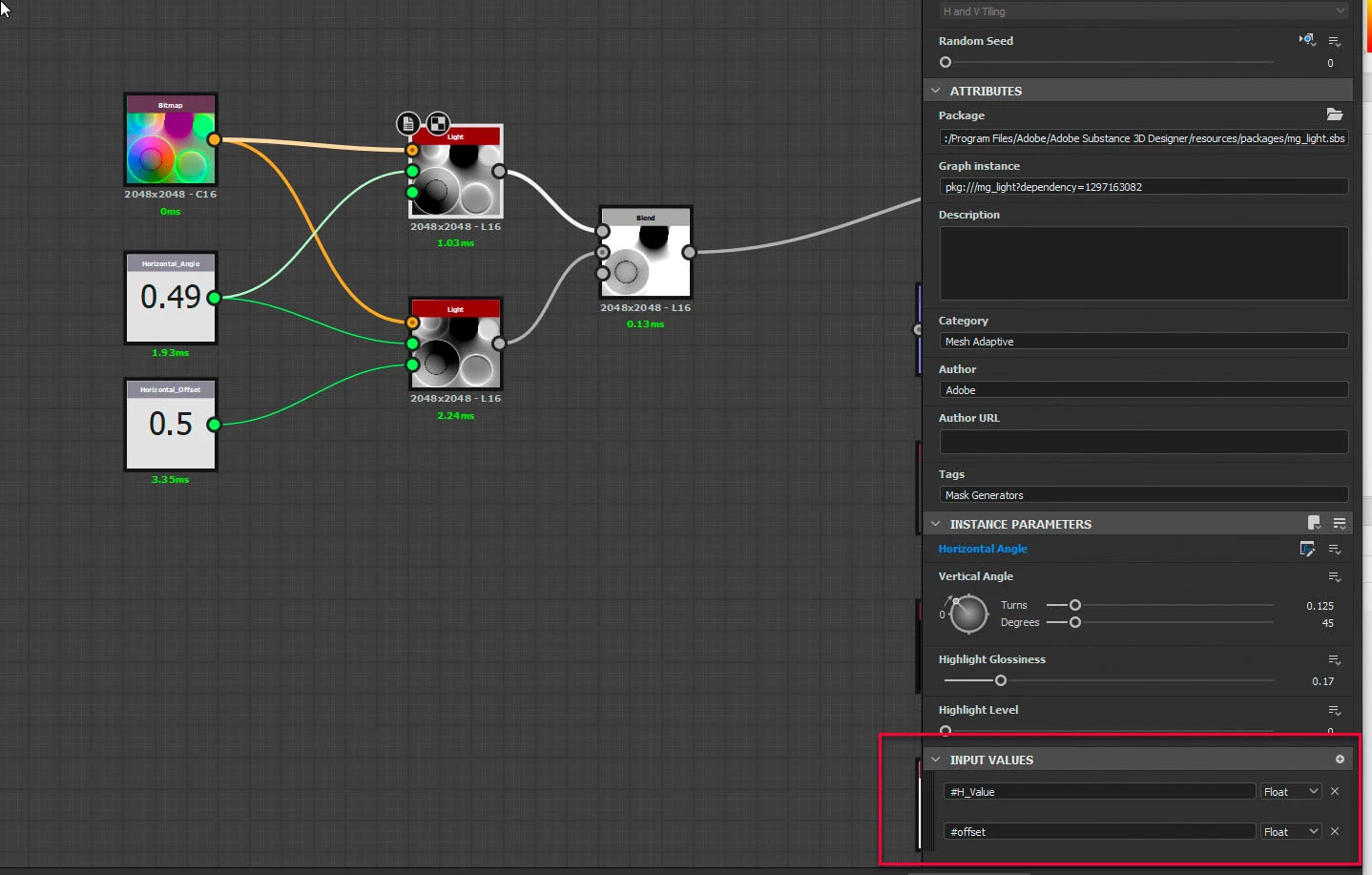

You could do this :
Add two inputs to the Light node. Name the first #H_Value and second #Offset
Control the Horizontal angle with a function that adds those inputs:
Add to input value nodes - the first for horizontal angle and the second for offset. Connect just the Horizontal Angle value to the first Light node and both values to the second Lighht node. You now have control over horizontal angle and the offset between the two lights (0.5 offset = 180 degrees)
Dave
