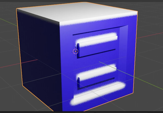

Edge select ?
Hello
how can i recognize edges without baking ?
Is it possible to recognize steps to put dirt running under it?
thanks

August 9, 2022
You need to bake in order that the simple material nodes can recognise edges, curvature, position etc. Without it the material nodes have nothing to work on.
Dave
August 9, 2022
what about recognizing steps to make splashes of dripping dirt?
it's possible ?
as ?
davescm
August 9, 2022
Any material which has to respond to position (e.g. drips) needs a position map to tell it which way is 'up'. That way drips can run down
You may find it more effective to design materials in Designer but apply them to models in Painter
