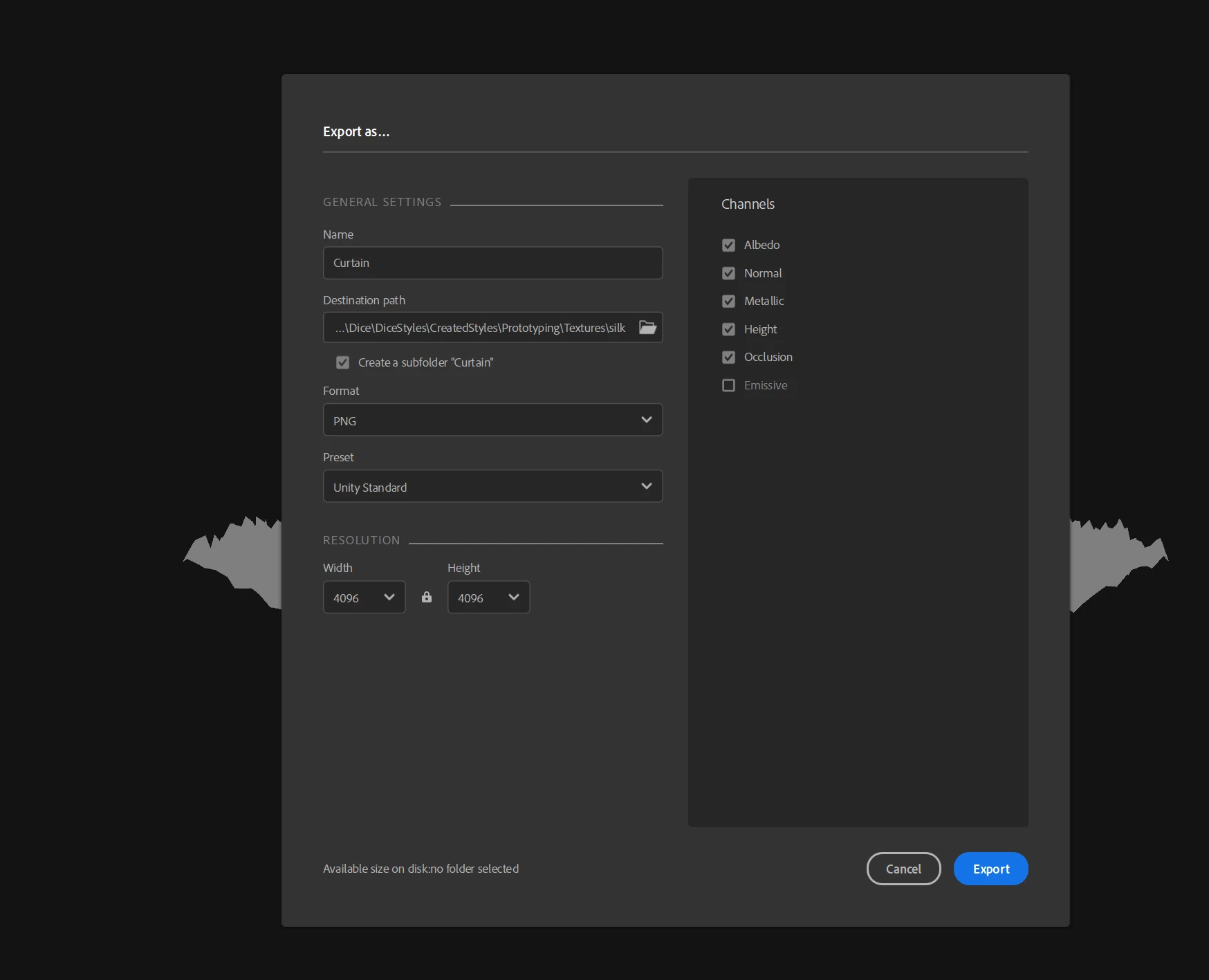

Also have a look at substance sampler that might be a better fit for you if you like using player, I just remembered as soon as I posted 🙂
get the archive in there you can send it direct from the asset site play around with as much as you like then choose export as and there's a range of unity and other engine default packing that will do all teh conversion for you.
