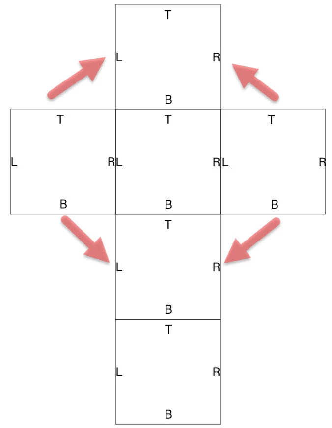

Hi
A material normally tiles left edge against right edge and top edge against bottom edge. So when on a 3x3 grid the joins can be made invisible
However when a cube is unwrapped, on eight of the edges that tiling works but there are four edges which have an additional requirement over and above that left to right and top to bottom tiling.  For those edges the top meets the left, the top meets the right, the bottom meets the left and the bottom meets the right. To make all those joins tile seamlessly, as well as the other eight, then you will need to bring additional symmetry into your material.
Dave
