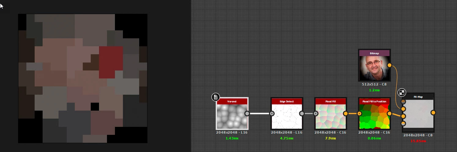

Hi, how can I use the Flood Fill to Position node to access each point position from this node within a FXMap node. I tried a sampler node within the FXMap functions; by using the correct input image node that being the Flood Fill to Position node in for example input 1 to sample the point positions but I'm not getting any result ?

This might help:
An image is connected to Image 0 input of the FX-Map and a Flood fill to position connected to Image 1 input. The idea is to sample the image input at the centre position points of the Flood Fill to Position node, and map them into a grid.
The overall graph looks like this :

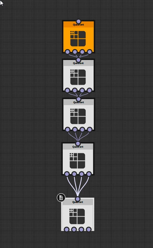

The FX Map looks like this - just creating a grid for the output

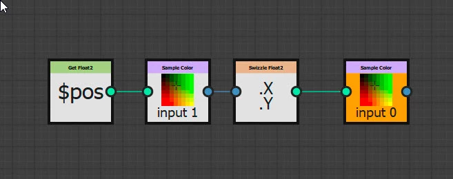

The colour/luminosity of the bottom quadrant node is driven by this function.
Reading from the left, the function gets the position of each grid square and uses a sample colour to read the value from input 1 (the Flood Fill Map). It uses the red and green elements as X and Y co-ordinates to sample Image 0 (the picture). So for each grid square it is sampling Image 0 not at the centre of the grid square but at the point dictated by the flood fill position node.
I hope that helps explain how you can use it.

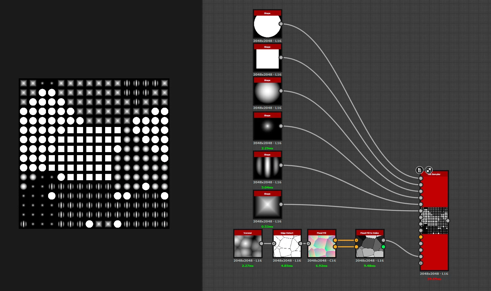

Thanks, so I assume flood fill to index works identically ?
Also could I send you a scene file as I'm unable to get this working using a tile sampler as an input ?
davescm
May 23, 2023
Flood fill to index gives a greyscale value (the index) to each cell in the flood fill map. That can be used within functions or to directly look up values or inputs as I have done in the tile sampler example below.
