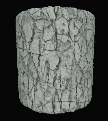

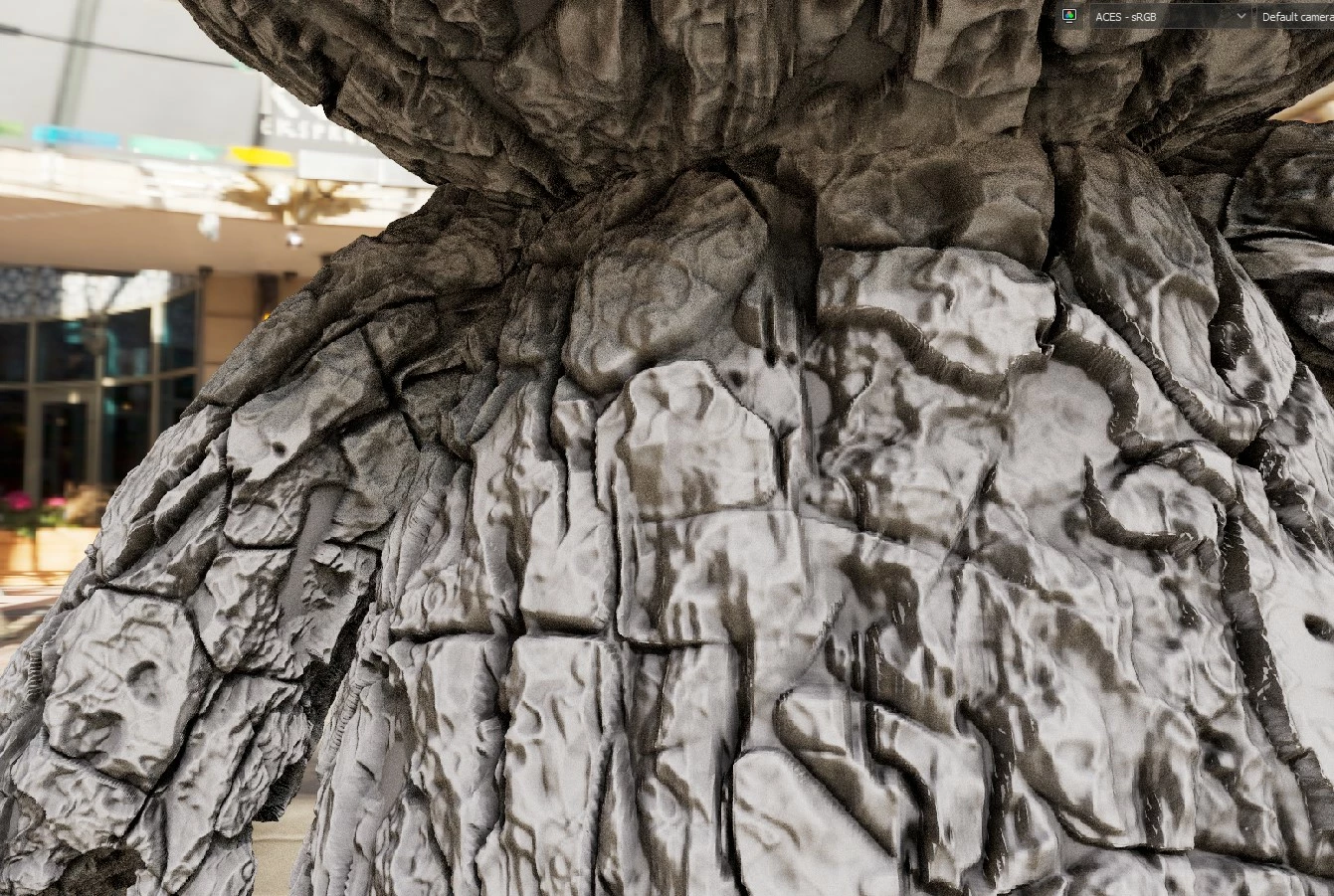

When working with displacement in mind, is it still a good idea to generate normal maps from the height map? It seems like when that is done, the normal map does weird things on top of the displaced geometry at render time. Looking for some gidance where this is concerned, thanks in advanced.

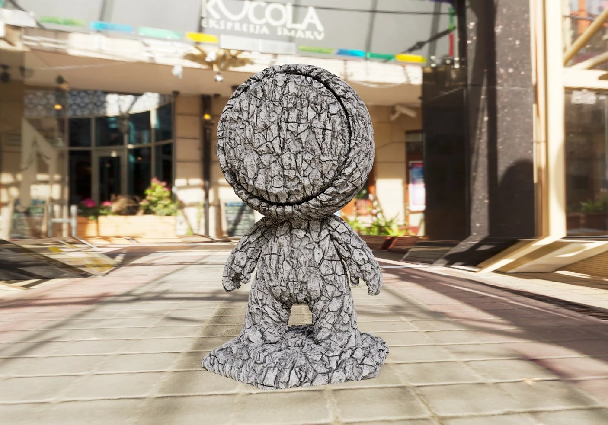

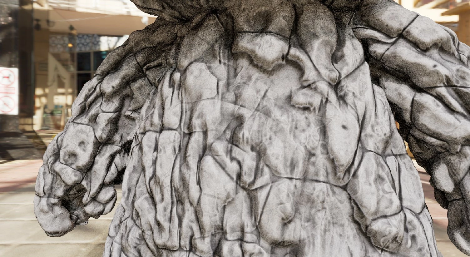

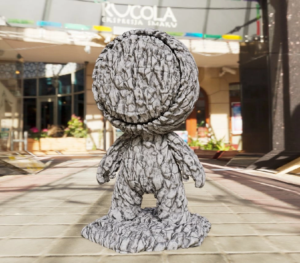

Many thanks for responding Luca, So, after doing lots of experiments and looking at some well done materials by other artists, then reading the substance PBR guide I've realized that maybe my height map was a bit too high frequency and high in value (I'm still not fully if that's the issue) so I applied some blur and toned it down a bit; That did give me more favorable results. Thoughts? Also, how would I generate the normal from displaced geo and pass it back to shader in painter?
