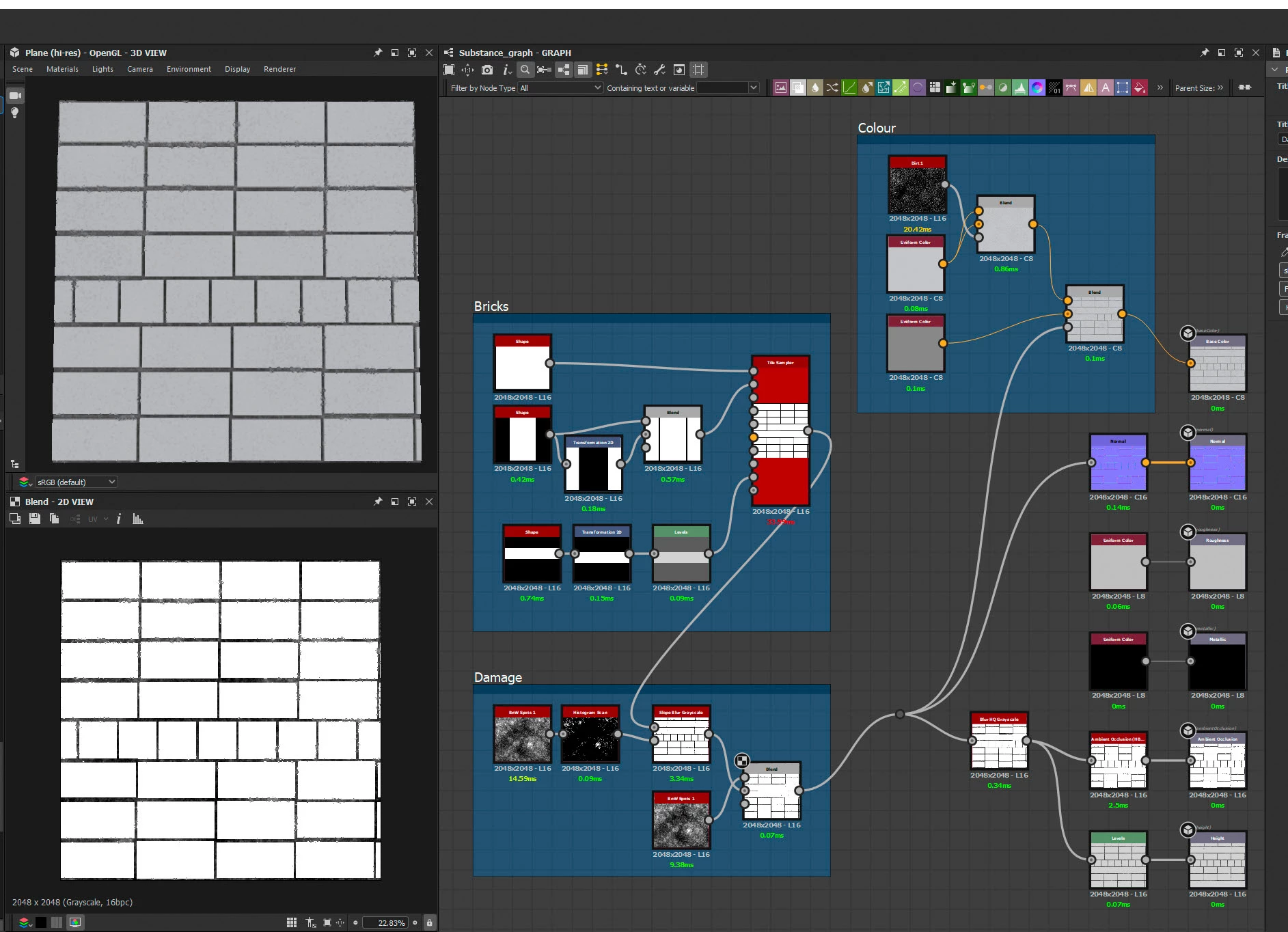

Something like this?
It uses two patterns inputs to the Tile Sampler node. Then a mask in the Pattern Distribution Map input of the same node to switch between them.
The edge damage is a noise and slope blur node.
I hope that gets you started.
Dave
