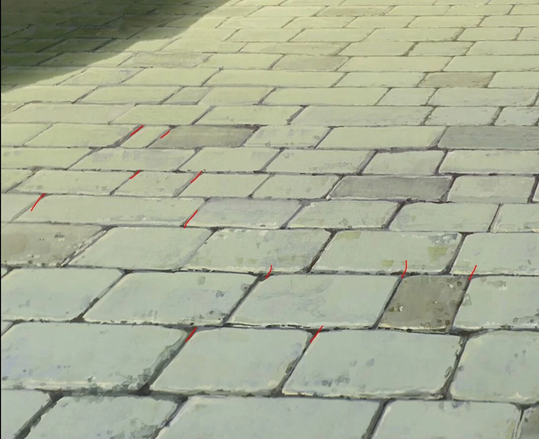

I am wanting to creating tiling patterns, say a brick pattern, that uses different sized inputs in the width, but does not leave any space in the pattern, see attached example.  I do not wish them to be completely 'random' as I'd like to input custom sized pieces.

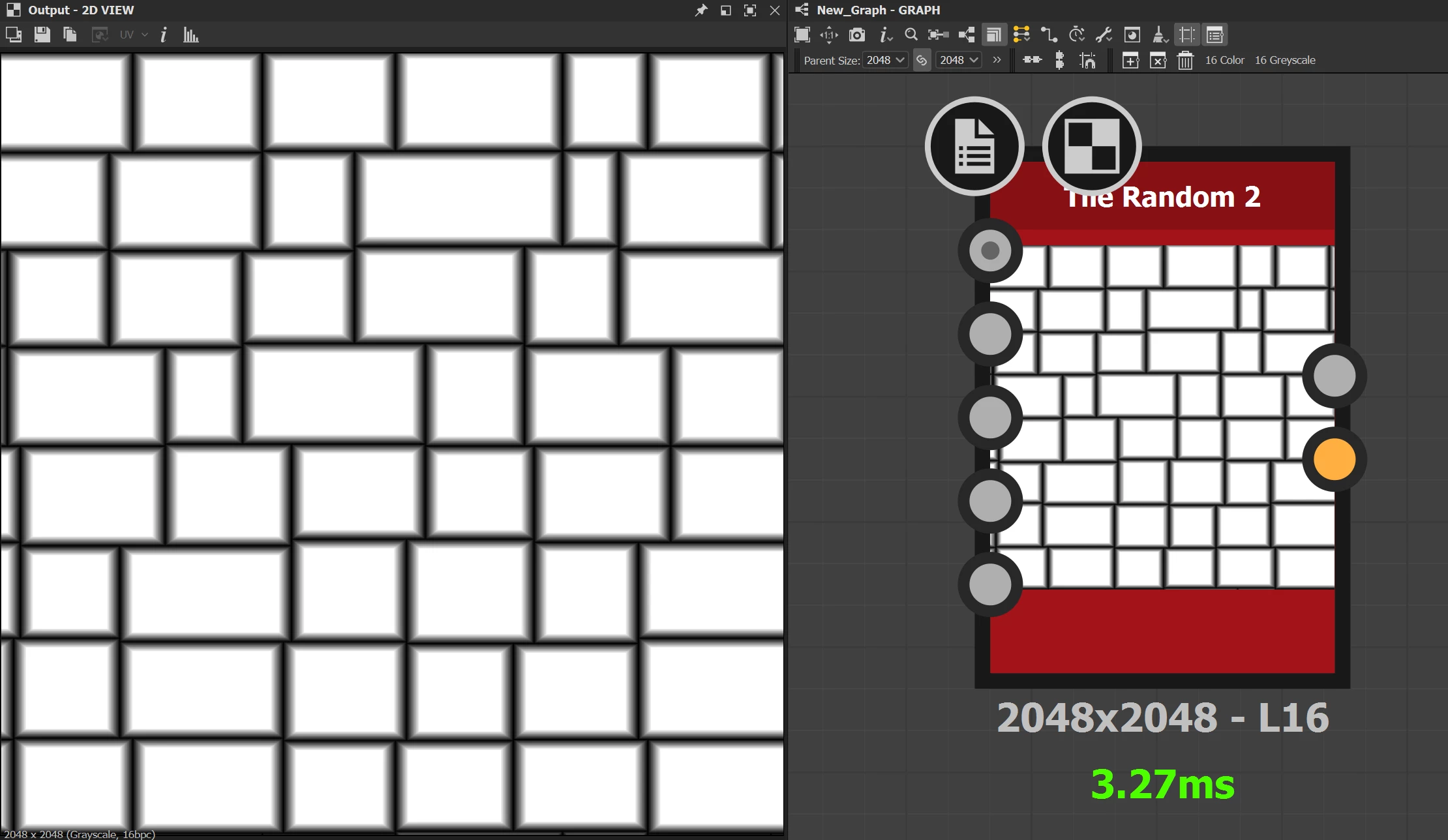

For a brick pattern, the easiest answer is probably to use a Tile Random 2 node and turn down the Random Y to 0.

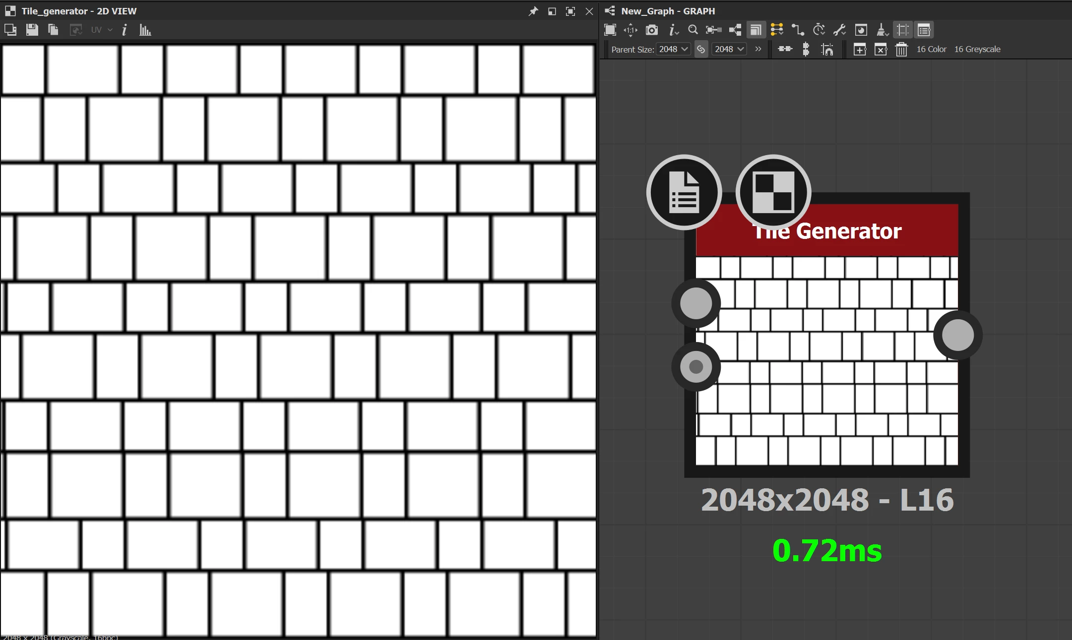

Alternatively, you could use a Tile Generator and edit its Horizontal middle size parameter and its Offset parameter.
The Tile Generator has the advantage of taking custom inputs where the Tile Random 2 don't.

It would seem my verison(older Steam Ver.) does not include the Tile Random 2 node, only the Tile Random.  What I find with this node is I can get 2 shapes by messing with the Random Y and offset (this was my original idea, happy to know I wasn't far off ha)
  I was hoping to use custom inputs.  When running unique shapes into the pattern inputs, there are always gaps between the shapes, that I cannot seem to remove.  With the Tile generator or Tile Sampler  See attached image.
Is there a work around for this issue? As I think this would solve everything.
