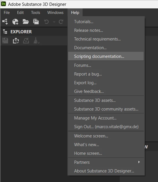

You can also find the Scripting Documentation in the "Help" Menu in Substance Designer:
Stay healthy and creative
