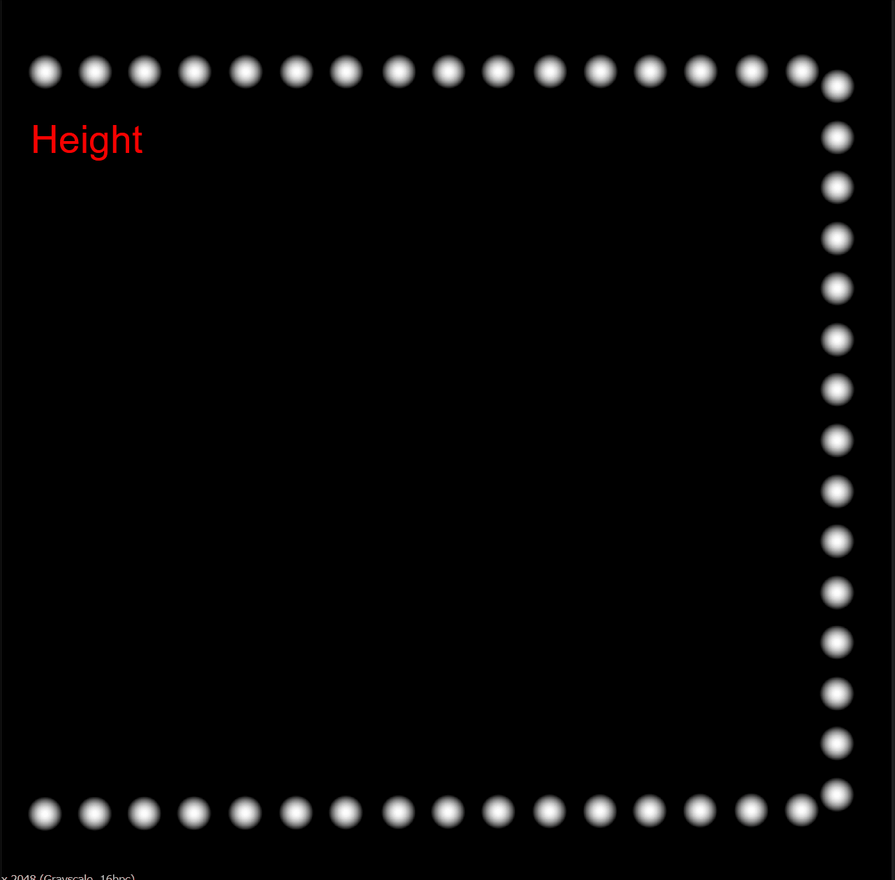

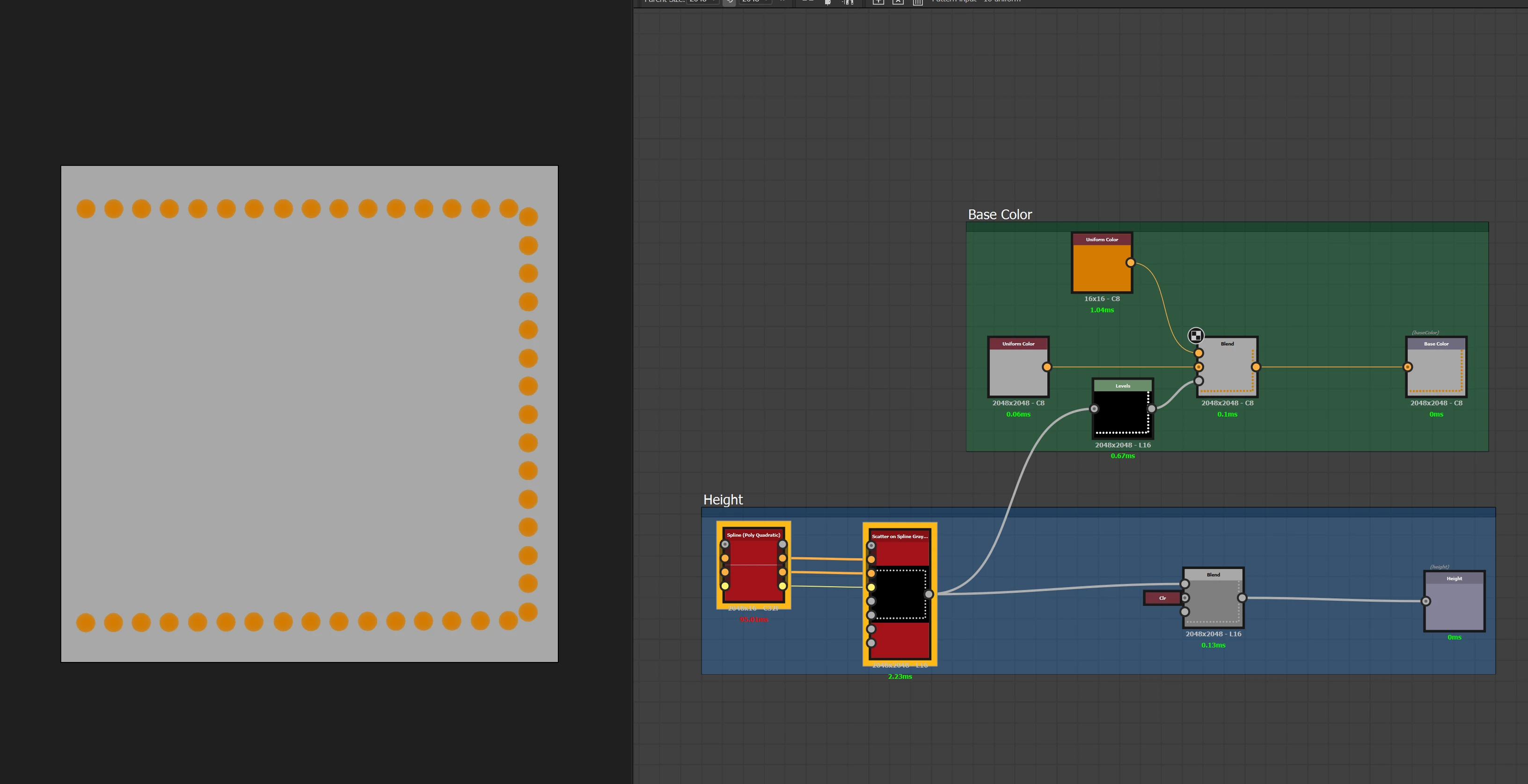

The common workflow in Substance Designer is to work with the Height map before starting to work on the color/roughness/etc. Usually, we use the nodes made for the Height to create masks for the rest.
I.e. you splatter the screws for your Sci-fi panel, so you can now reuse the nodes form the screws in order to build a clean mask, and plug it to the opacity of a blend (which will be linked to the Base Color output).
