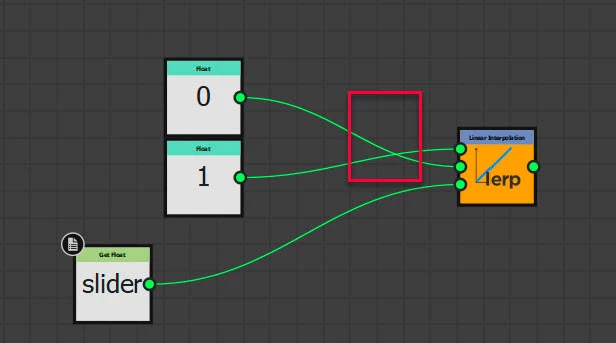

Its been a while since i played with designer, I forget how to invert a parameter vaule? lets say I am remapping a float vaule  into a liner interpolate. How do I invert the vaules. Right now my slider is going in the wrong direction for what i want it to do, hope that makes sense?

Putting that function ahead of whatever is your next step does invert the slider's action - just make sure that the values for float 0 and 1 are changed to match whatever you have set as min and max.

For use with lerp just swap the a and b inputs to invert the output of the interpolation
In the example below, as the slider value increases, the lerp output decreases
Dave

Yes, but its the slider action in the parameter that I want to invert

davescmCommunity ExpertCorrect answer
October 11, 2022
