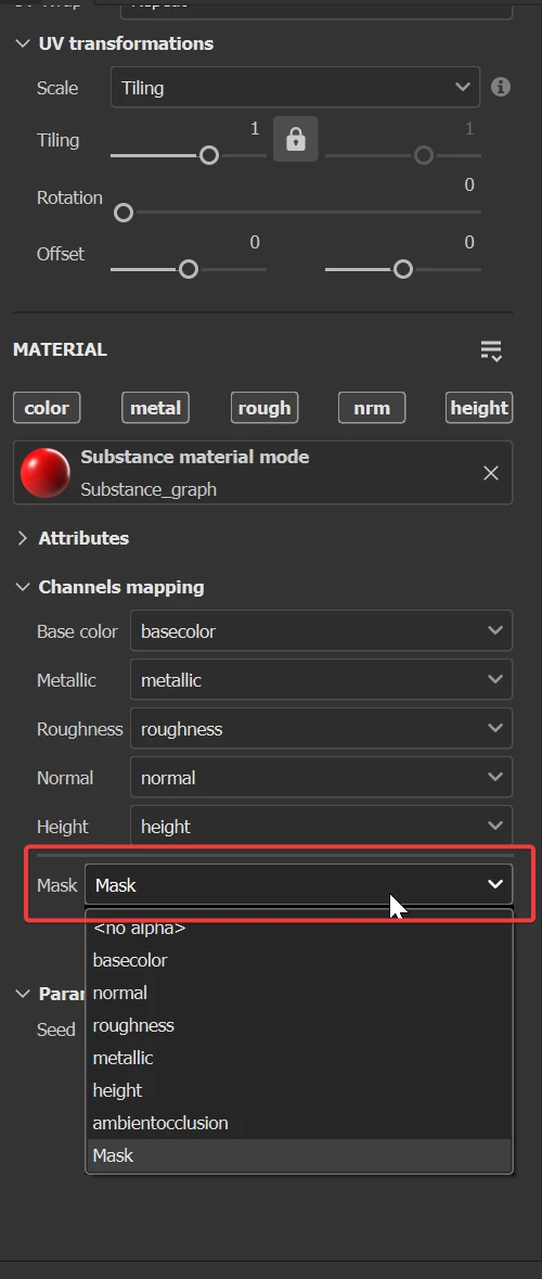

Cyril Dellenbach
April 18, 2023
Sorry, I misunderstood the issue.
In your substance graph, you can add a mask output and use this output inside Substance 3D Painter under the Channels Mapping.
If you want to natively set the output as the mask inside Substance 3D Painter, you can add the command isChannelsAlpha=true in the User Data box of the ouput.
