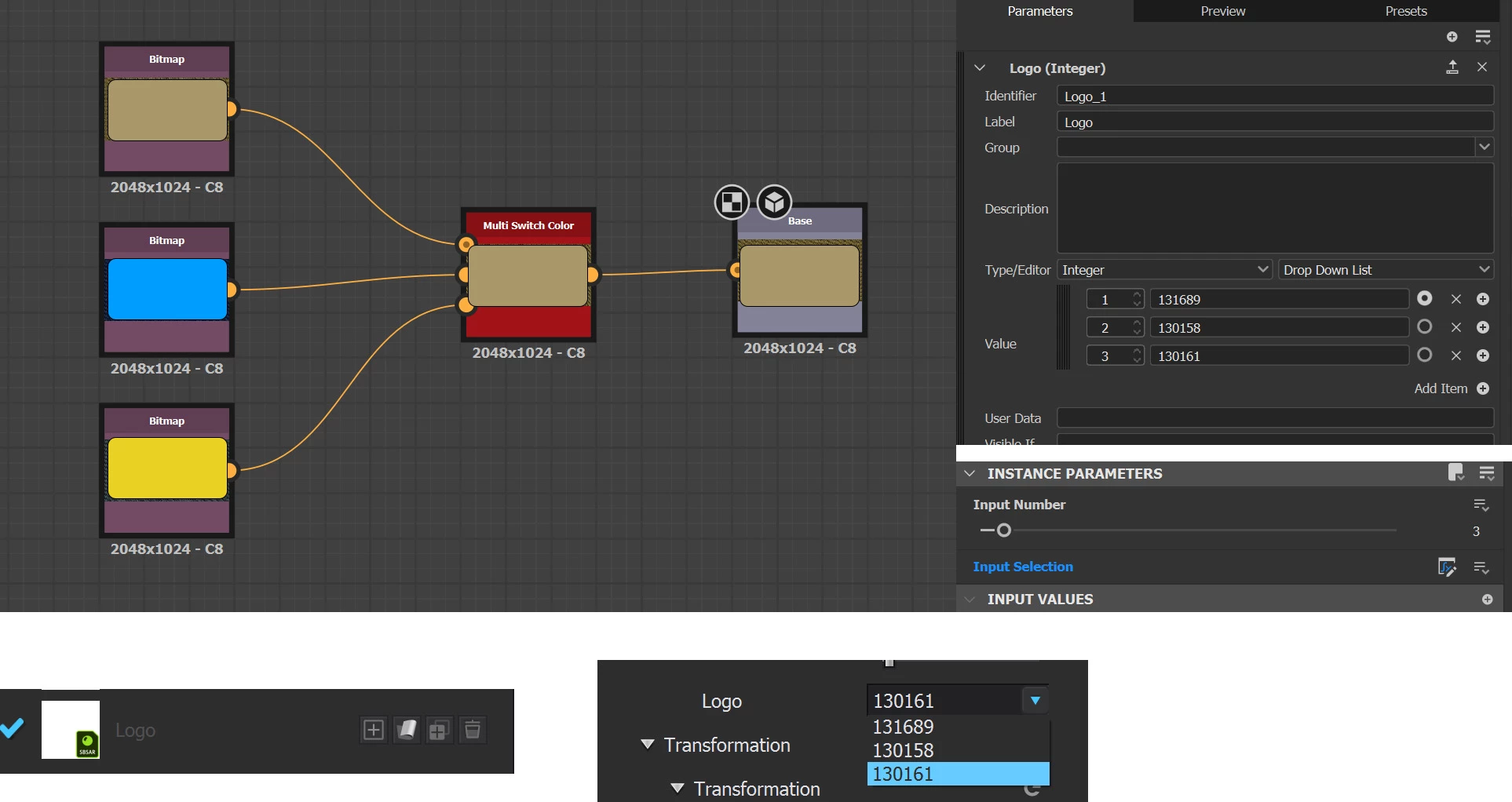

I am trying to do something very simple. I have 3 logos (imported them )  and trying to expose the parameters so i can switch them in CLO3d. Attached an image of the issue. When i bring the sbsar file , it appears as white, the expose parameters are there but it doesnt work. I also tried to expose the input number but didint work either.. Any idea where i am doing wrong?
Thank you

I can't see anything wrong in your screenshots. Can you share the SBS file (replace the logos with another image if they are confidential)
Dave

Thank you for the reply. Attached the sbs file.. They were tiff and  i switched to jpg to see if it will make any difference but it still didint work 😕😕 it works in Designer but when i publish as sbsar  the paremeters are there but its all white and it doesnt work

Thanks for sharing the SBS. It gave an warning error when I opened it as I did not have the associated resources file, but I substituted 3 bitmaps of my own and published to SBSAR. That worked correctlyand embedded those bitmaps within the SBSAR and on using teh sbsar I could switch between the images using your exposed parameters. So there is nothing wrong with the graph build or parameters as such.
The white you describe would indicate that for some reason your bitmaps are not being correctly embedded within the SBSAR file on publishing.
If you can send the associated resources file, I can try with your images rather than mine.
