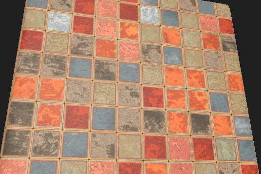

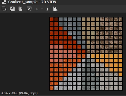

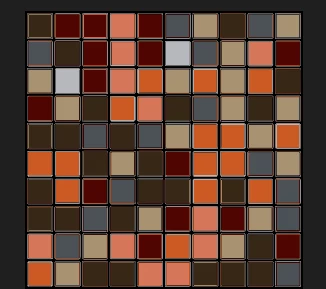

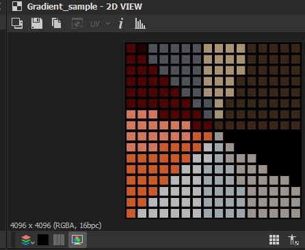

Hello! I’ve been trying to troubleshoot an issue and I was hoping for some suggestions to try and fix this issue. I built a package that accomplishes several QoL functions. Inside the package/graph it functions perfectly. When linked to any other graph, including its duplicate, quality loss causes several functions to cease working. Pictures included show some examples of this loss comparing outputs in original graph and to linked results. Top two are the results after being linked while bottom two are the original results. The section I have for scanning dark values via histogram scans tends to be dropped after being linked- and the section I have that introduces samples of colored noise tends to blur towards singular color values.
The graph uses only atomic nodes, heavily reliant on scans and blends. I’ve tried changing the graph properties output format and resolution to absolute, adding transform nodes after inputs to inherit parent properties, and upping bit depth to double the graphs original value for the scan outputs but data is still lost or heavily compressed down the chain. I’m still actively troubleshooting but am at a loss with this. Any suggestions would be great!
