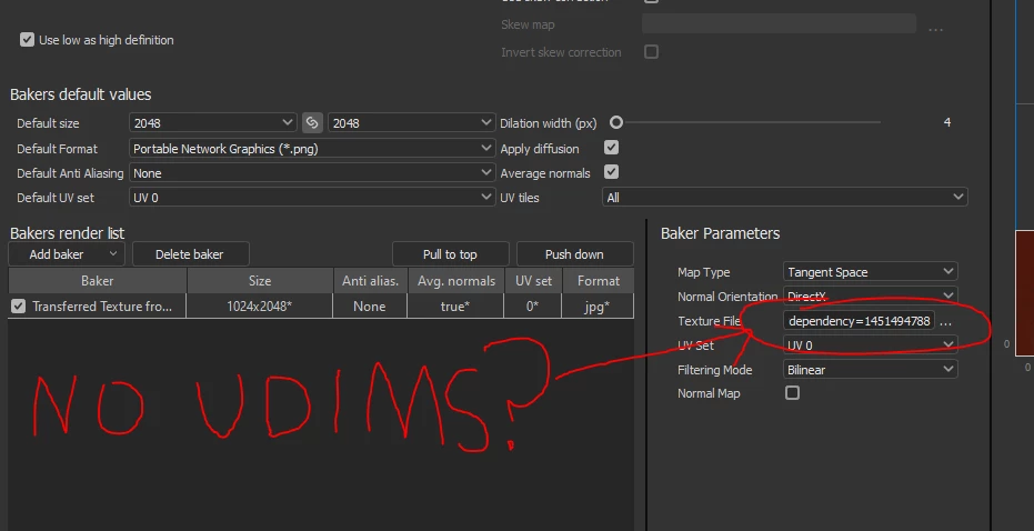

Question about UDIM to UDIM transfer texture from Mesh
Essentially I'm trying to bake the textures of a model that has over 100 tiles to the same model with 10 better packed tiles. My understanding is Designer can't load UDIM sets in the 'Transferred Textures from Mesh' Baker Paremters even though I am using a UDIM set named "texture_[udim]" in the load from resources dialogue. When I bake it seems to choose only a single tile from the UDIM set I want to bake from and bakes that onto my 10 tiles. Is this correct? Designer can't use UDIMs to bake from?

Hi @gavijn25494013srkk, @Ioan25985093nz0p  and @marekb22187191,
Sorry for the delay in response.
Unfortunately, our bakers don't support the UDIM workflow, therefore reprojecting UDIM into less UDIM won't work properly. We are aware this is an expected feature, but I can only ask you to be patient.

I made a tutorial on how to do UDIM to UDIM transfer/reprojection
https://www.artstation.com/artwork/8BbLVx
It has a few steps , but if you do it once, its not complicated.
Hope this helps.

Feb 20, 2024 4:57 AM UTC
Just wanted to check and see if there were any updates to this potential feature. I am also trying to do a UDIM to UDIM texture transfer in Substance Designer. If the feature isn't implemented yet, are there any workarounds I could try? I was thinking maybe splitting up my model by UDIM tile and baking the tiles one by one in SD, but I have yet to test the theory. Any ideas?
