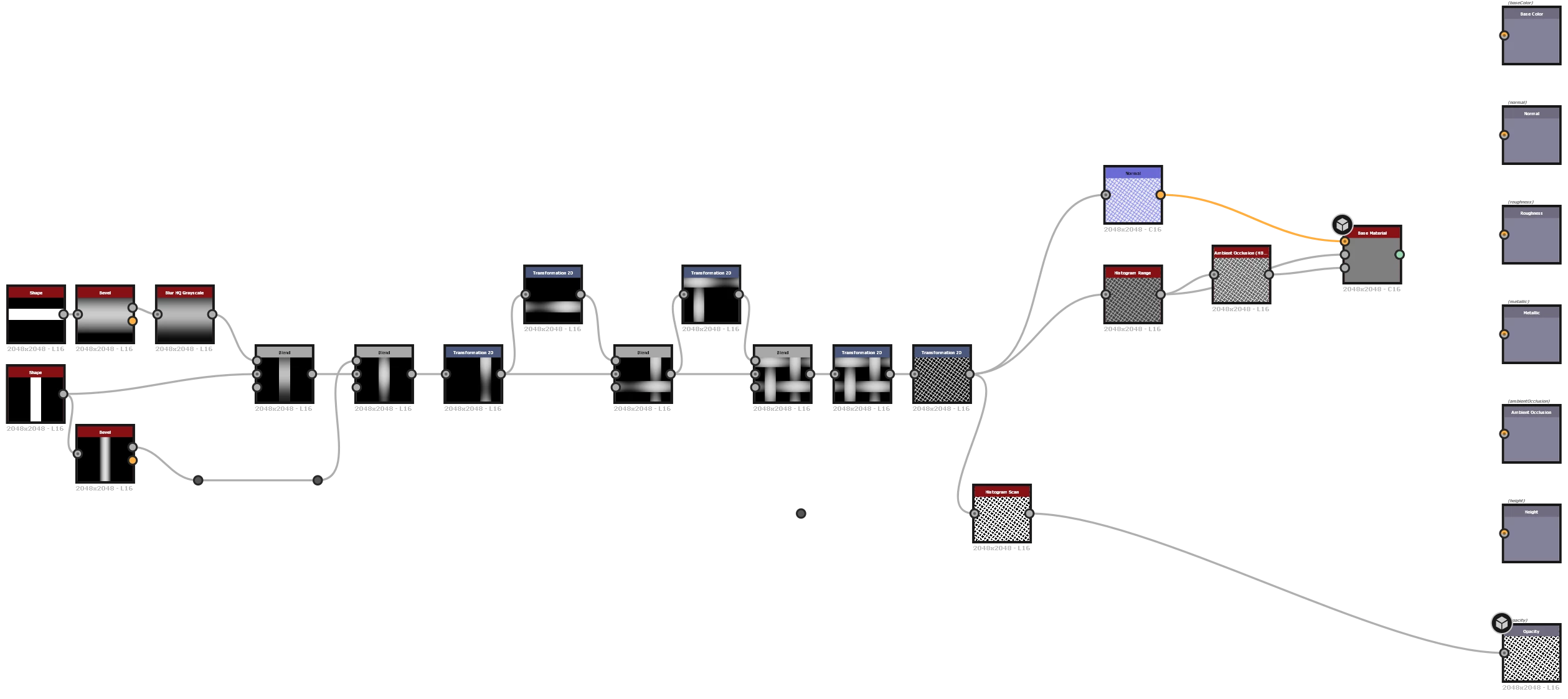

Im new to designer and im trying to correct this weave so it aligns right but can't seem to figure it out.
I attached a image of my workflow and my actual work down below. Any help would be greatly apperciated

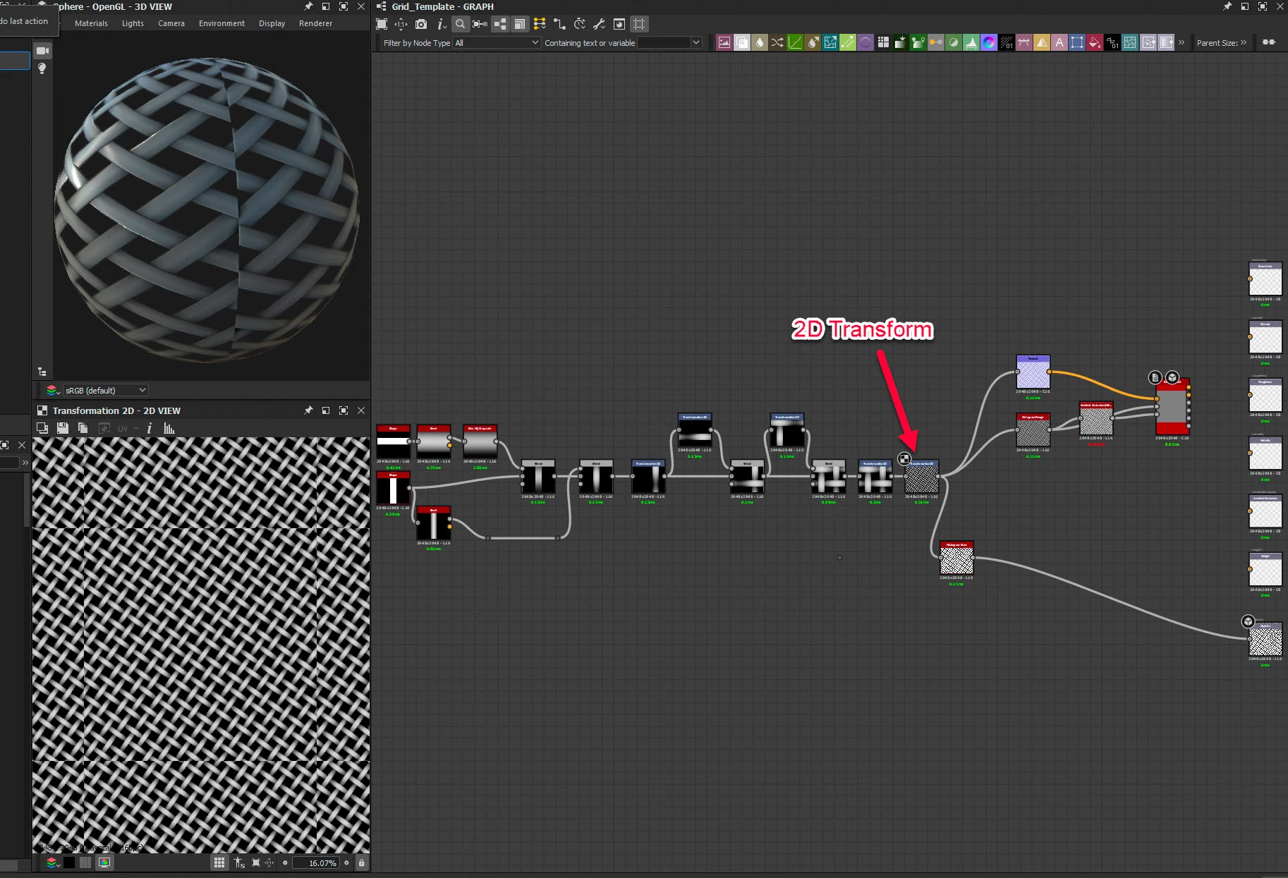

The problem comes from the transform 2D node which is scaling and rotating the pattern and is breaking the tiling.
Turn on repeat tiling in the 2D view and you will see the issue.

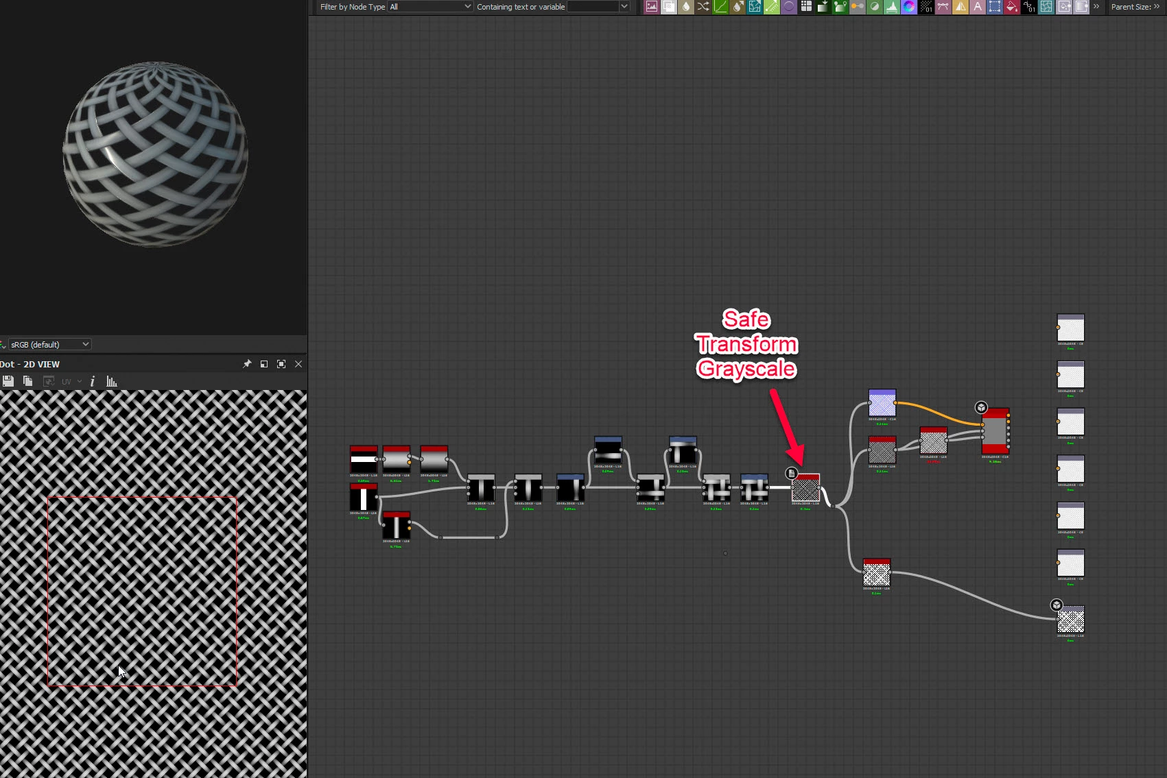

To fix it adjust the rotation until it tiles correctly you could try a 'tile safe rotation' node. This will restrict you to values of rotation that will tile correctly
