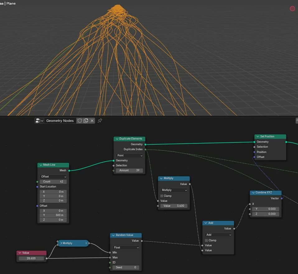

Does anyone  know  right way  or could point me to a relevant tutorial?  I need not a tree like "splines on a spline"  but rather  vertical splines  with random subtle  waviness    getting random x and y shift  .
  Is there something like index parameter   in spline nodes  like inside fx map node ?    A way to  set spline quadratic  node spline amount to say 10  and  use each spline index  to give each its own subtle  random points  wavines .     A super easy to do thing in Blender geometry nodes  with clear and easy preview  but I broke my mind alredy trying to do it in Designer.
I see I can do  10  pre-made  splines manually   with some functions controlling  points position  for each of them individually ,   map a texture on splines,  and then feed each one to fxmap node  to shift in 0-1 space. Is it  only way?
I mean in Blender I can use line primitives  with arbitrary number of point  always distributed  proportionally , resample  curve  node and so on and on.      Maybe  someone have and can share   such line primitive done for designer  ?

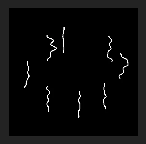

Maybe such a technique can help:
  • Use a 'support' spline to scatter other splines randomly. The support spline should be warped for that sense of randomness in the scattering.
  • Use a 'Spline render' node to color each spline with random luminance, then feed the result to a 'Distance' node to create a map we can use to adjust the intensity of warping for each spline later.
  • Warp the scattered splines using the intensity map blended with the noise/pattern you want to use for warping. The 'Spline warp' node offers start/end attenuation controls if you want to keep the extremities of splines in place.
Here is a simple example, using a 'Spline circle' node as support spline and simple noises for warping vertical splines.
This is the result:
Feel free to let me know your thoughts about how this solution can or cannot meet your requirements.

kirkr5689Author
Oct 15, 2025 10:23 PM UTC
Thanks a lot  Luca,     but I  really I hoped to recreate something like this .
