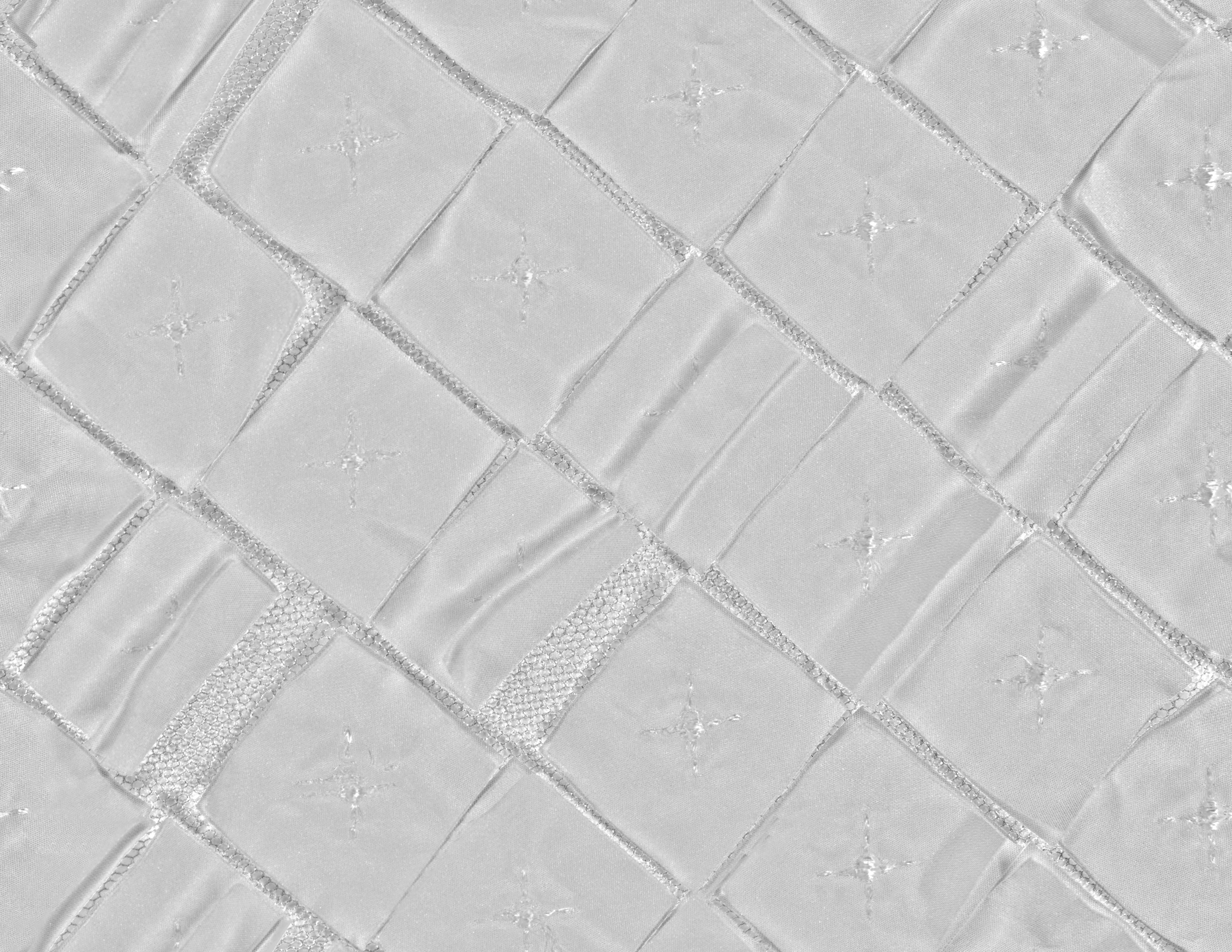

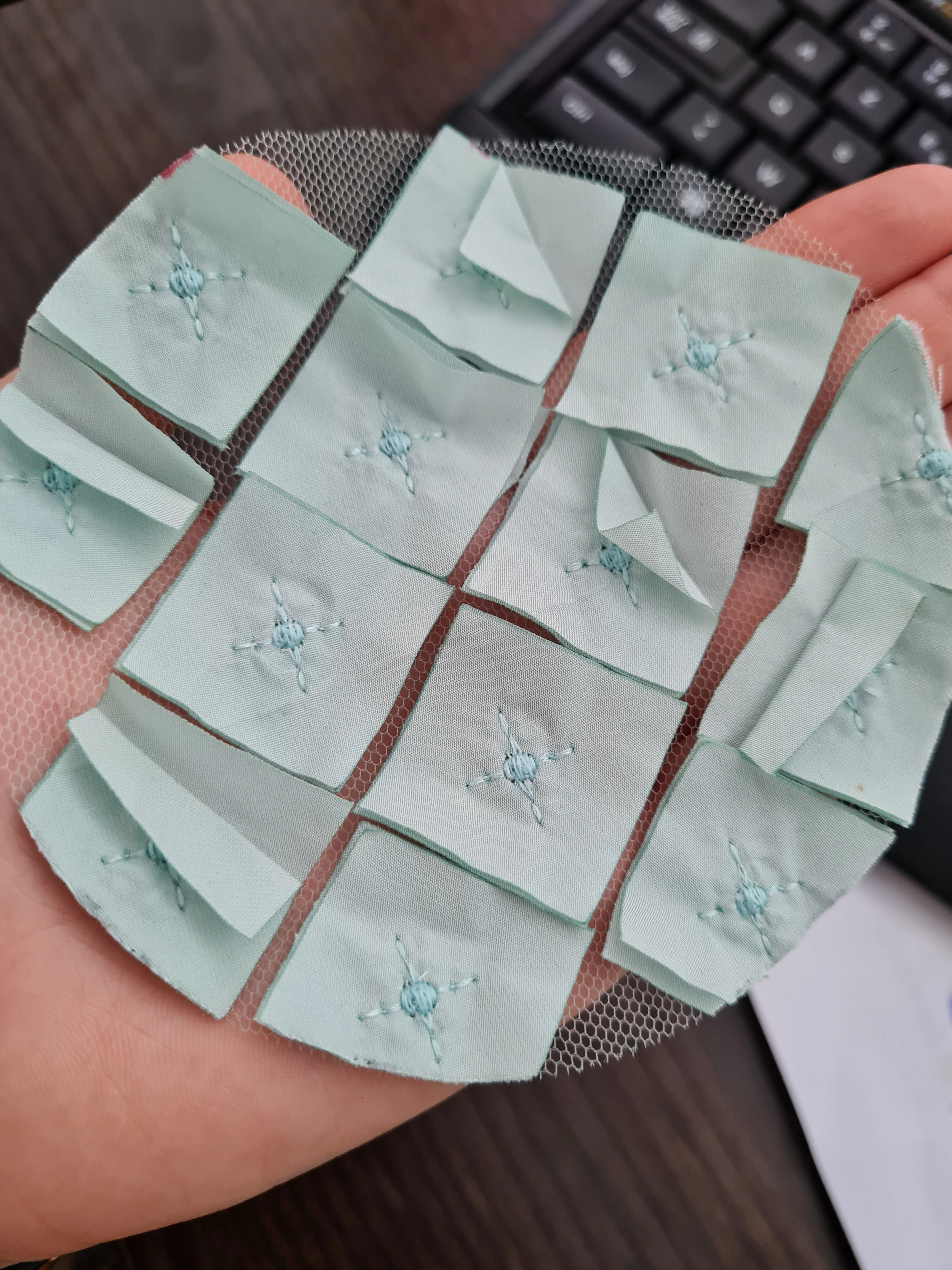

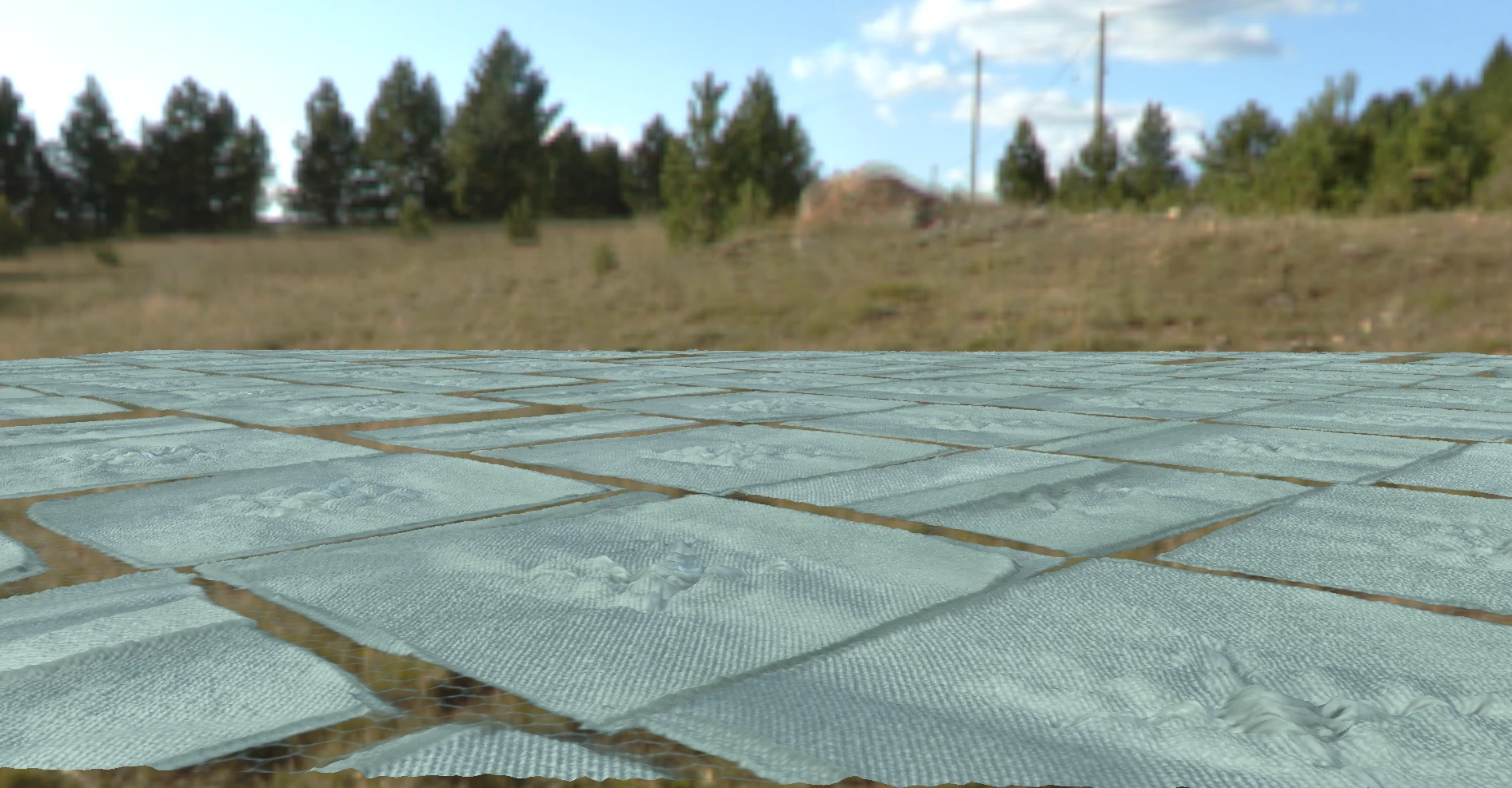

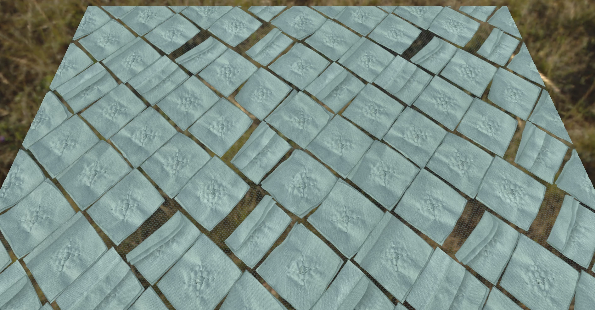

i have this material that i scanned and imported in substance designer , its a tulle with embroidered squares on top.
Some of them have pleats and some are pretty flat, and the one that have pleats do not come out as i want in the render . The height of them is not recognized 😕😕
Im pretty new to substance and i cant figure out what nodes to use for this !

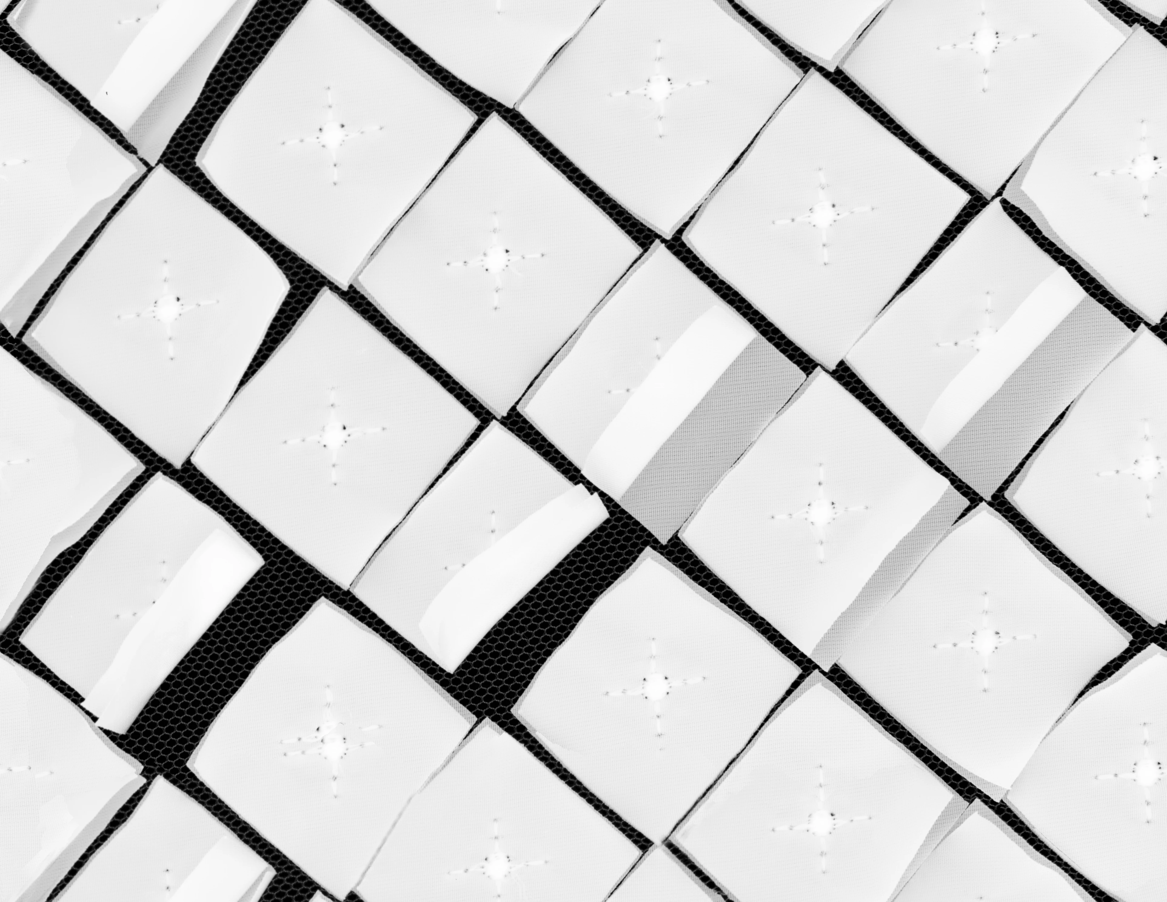

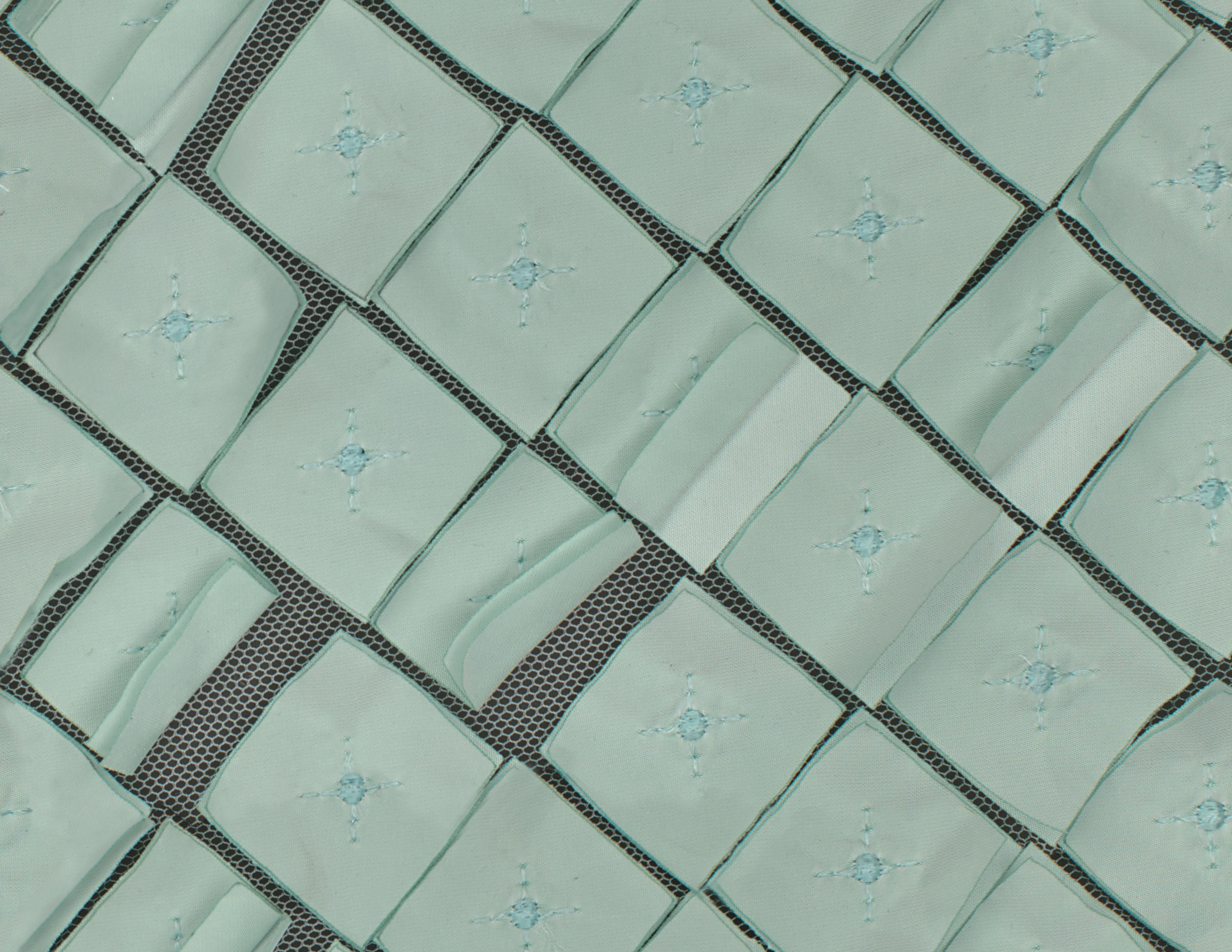

Thank you for your reply,
the input images used were from vizoo
Hopefully you can help my find a solution if there is one

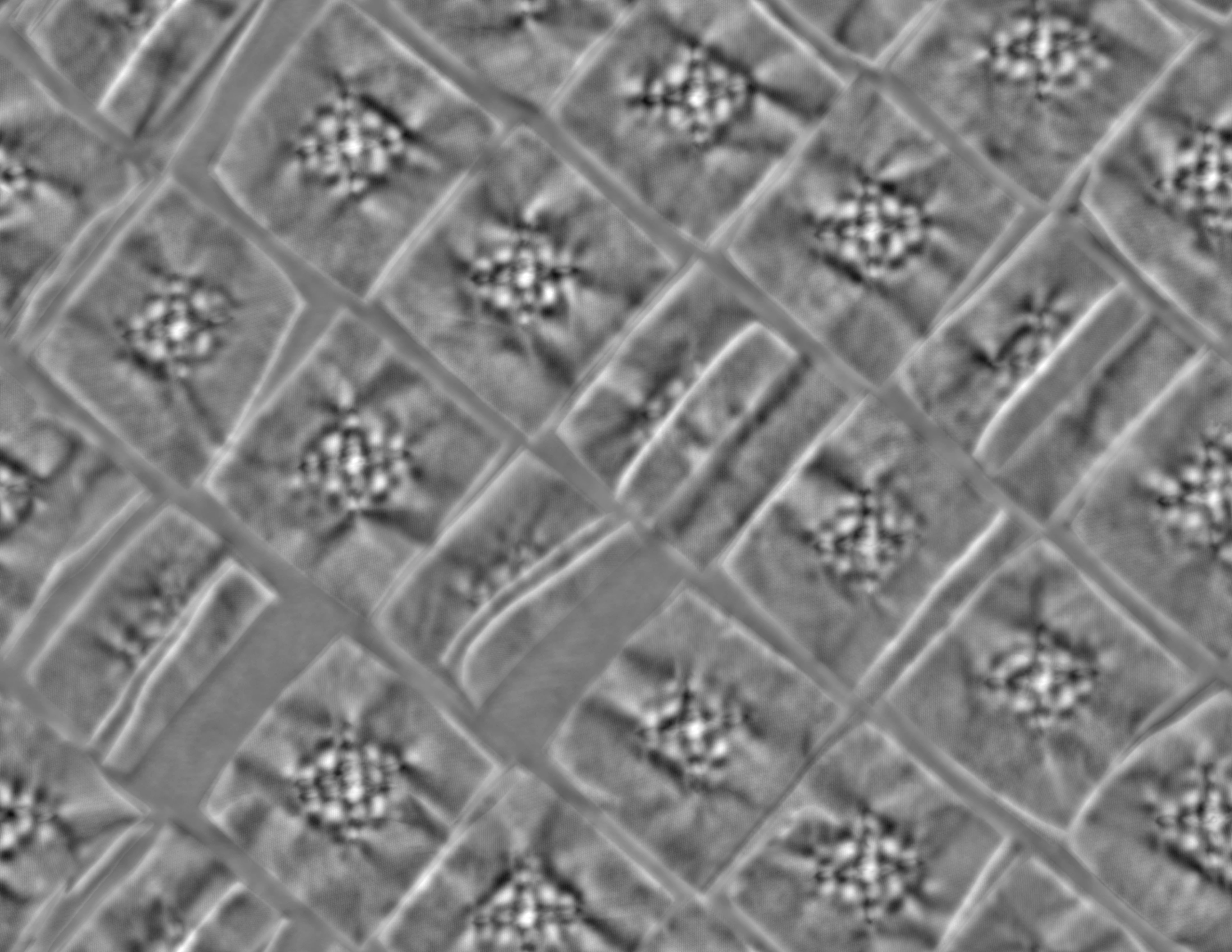

Thank you for providing these files. The displacement effect is the combined result of the Height map and the Height scale values multiplied against each other. I covered this behaviour in this thread and that one if that may help.

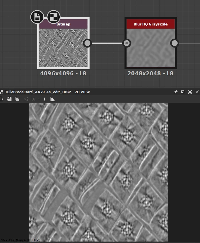

The farther the value is from the Scalar zero value in the height map (0.5 by default), the more it will be displaced. The height map output by the Vizoo system does not clearly separate the folded pleats by an offset greyscale value, so they will not be displaced that much.
In this example, the height map is blurred to try and soften the displacement effect so the folded parts are more graciously handled, but that is far from an good solution.
The issue appears to be at the scan stage where the height of the folded is flattened against the rest of the material sample. Maybe the Vizoo system or its scan parameters need to be adjusted to output a height map where folded parts are more clearly offset.
