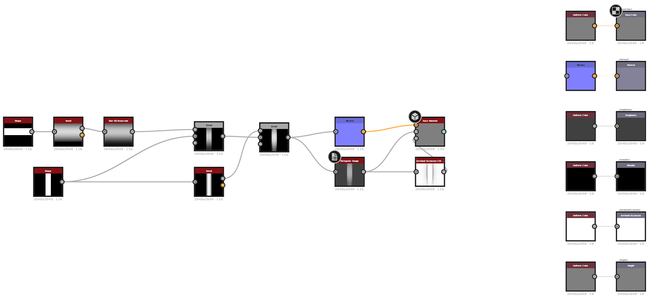

Im trying to recreate roundedness effect from the video shown below (9:10)
https://www.youtube.com/watch?v=csSutepJyEU

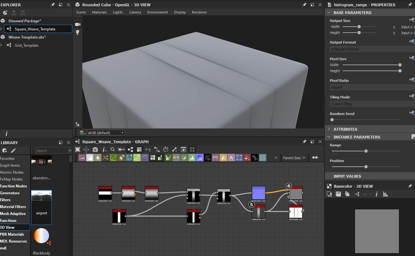

I double checked my work and made sure to use the same template but when I try following along all I come up with is a flat line as seen below 
I have attached a image of my workflow and a copy of my work below. Any help would be greatly appreciated

Hi

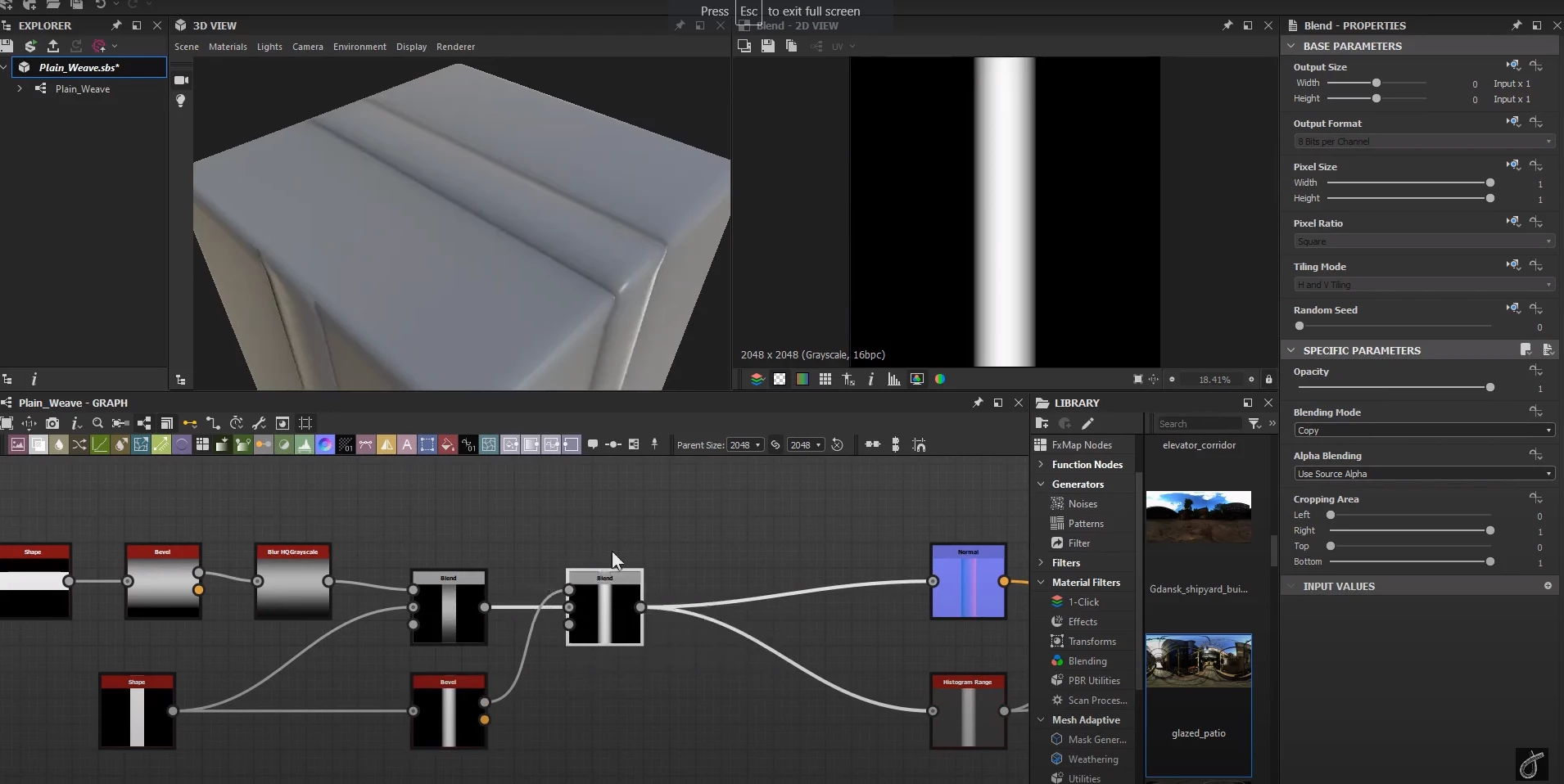

Try turning up the intensity in the normal node. In the video screenshot you can clearly see the normal map, on your example it is scarcely visible.
Dave
