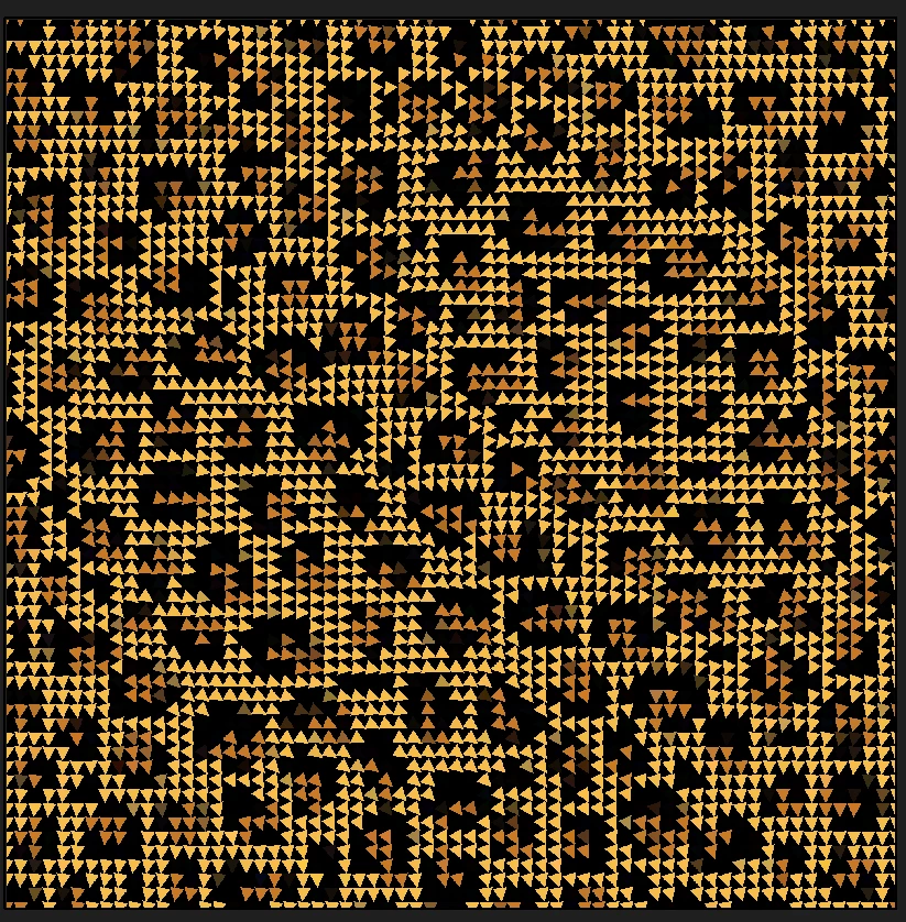

Hi, thanks for the reply.Yes, the tile sampler was an option i considered at first but it has some shortcomings i'm trying to address, the major one being the performance hit of having two nodes separated, that being one of the reasons i went with the FXMap, having a lot of shapes clustered in one place wasn't giving me ideal results and the solution i found was to mask them down, but that would also require me to add way more shapes than needed, for the quality i need for my project a single grayscale tile sampler was pulling off over 5s of processing time at 2k res, not even counting the rest of the node chain and the extra sampler for color, so having more control over the placement of each shape was handy, my algorigthm can distribute them based on the scale map, smaller shapes will fill less space are more packed together than larger shapes, meaning i can get decent results without having to blow out the overall shape count.

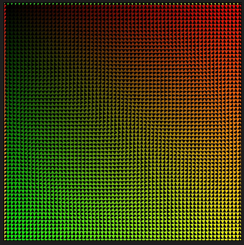

Overall,while the FXM can give similar results to tile sampler but with more control, both fails however when it comes to color. If i use it on grayscale mode, i get really decent height blending, but can't add color information to it. One way i could potentially get this to work would be by coloring each shape using the R and G channels as coordinates, and use a separate pixel processor to sample each shape and use their colors as coordinates to sample equivalent point in a texture and paint the entire shape with that color (example below), it would be enough for the effect i want, and i could use the extra B channel for height data, however i can't use the FXM to control the blending of each channel individually, ideally i would like the output image would have the shapes in the red and green channels completely opaque and only use the alpha information to set them above or below each other, however i don't have control over how each shape is actually blended together.
