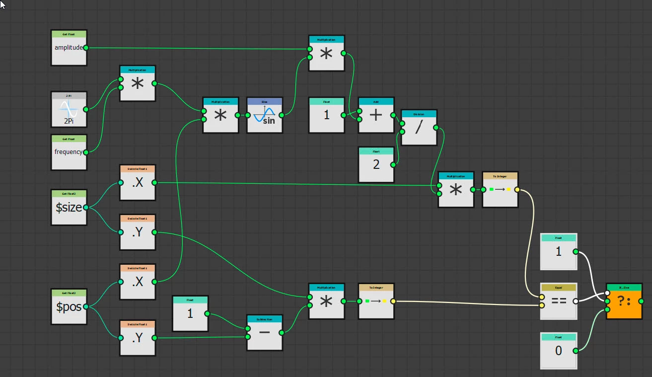

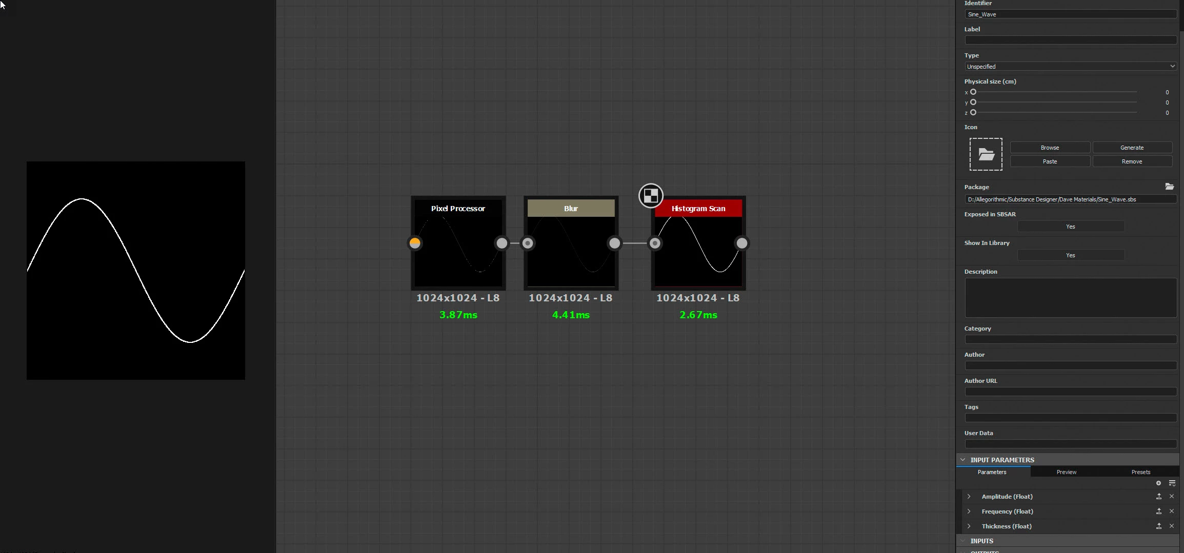

davescm
November 8, 2022
Thanks for sharing.
Here's an alternative using the pixel processor with control over amplitude , frequency and line thickness
Dave

Thanks Dave, very much appreciated.
The pixel processor is a node I'm still trying to learn and get my fingers behind, and from what I'm seeing so far this is definitely going to provide for a solid example that can actually be debugged, traced and thus help to get a good overview.
