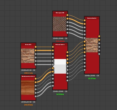

you can easily chain multiple Material-Switches together, depending on the amount of your input Materials.

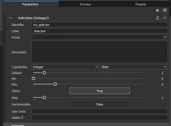

Then you create one parameter for the parent graph. I called it int_selector, which lets you choose the material you want to output.

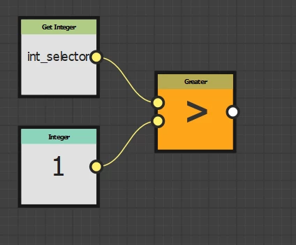

Inside the swith parameter of each Material-Switch you make a comparison, if it's greater than the last material index (I hope this is understandable)
This goes into the first Material-Switch Node
This goes into the next Material-Switch Node
And so on..
There are way better and faster ways to do this, but for the sake of simplicity this would be my suggestion.
