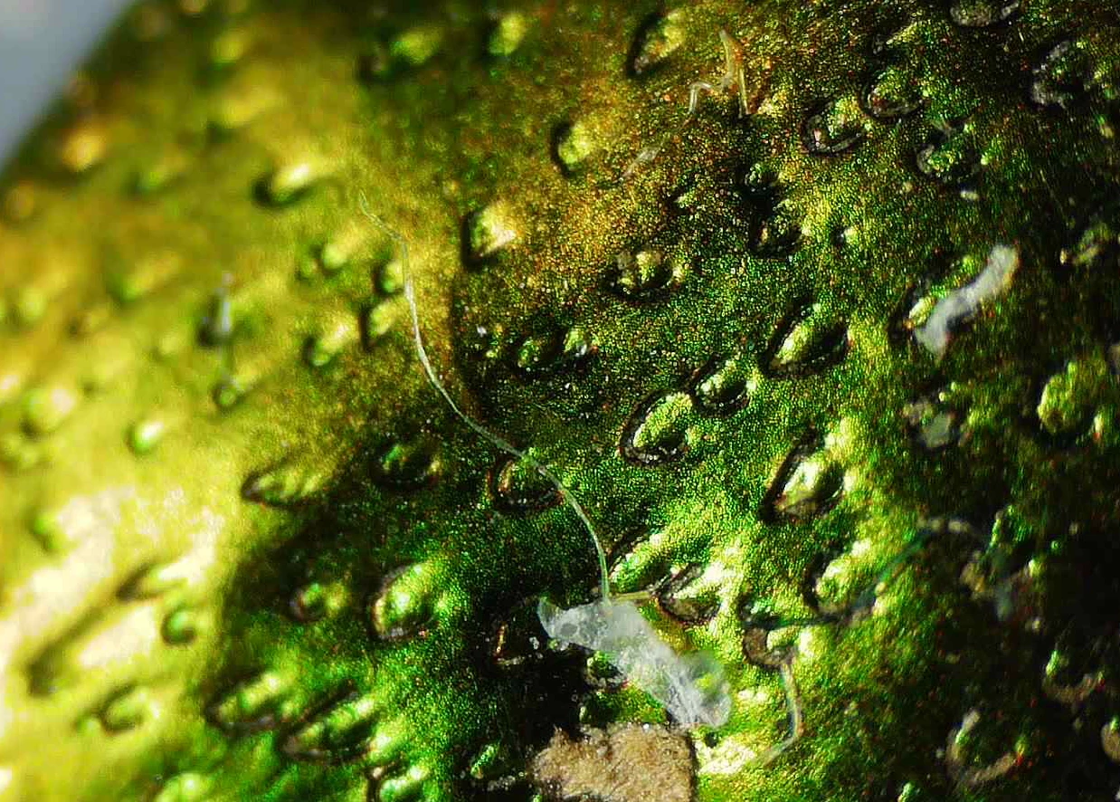

I am fairly new to Substance Designer and I'm trying to create a mask where spots/dots follow a somwhat swirly path - here's a couple pictures so it's easier to understand what I'm looking for:

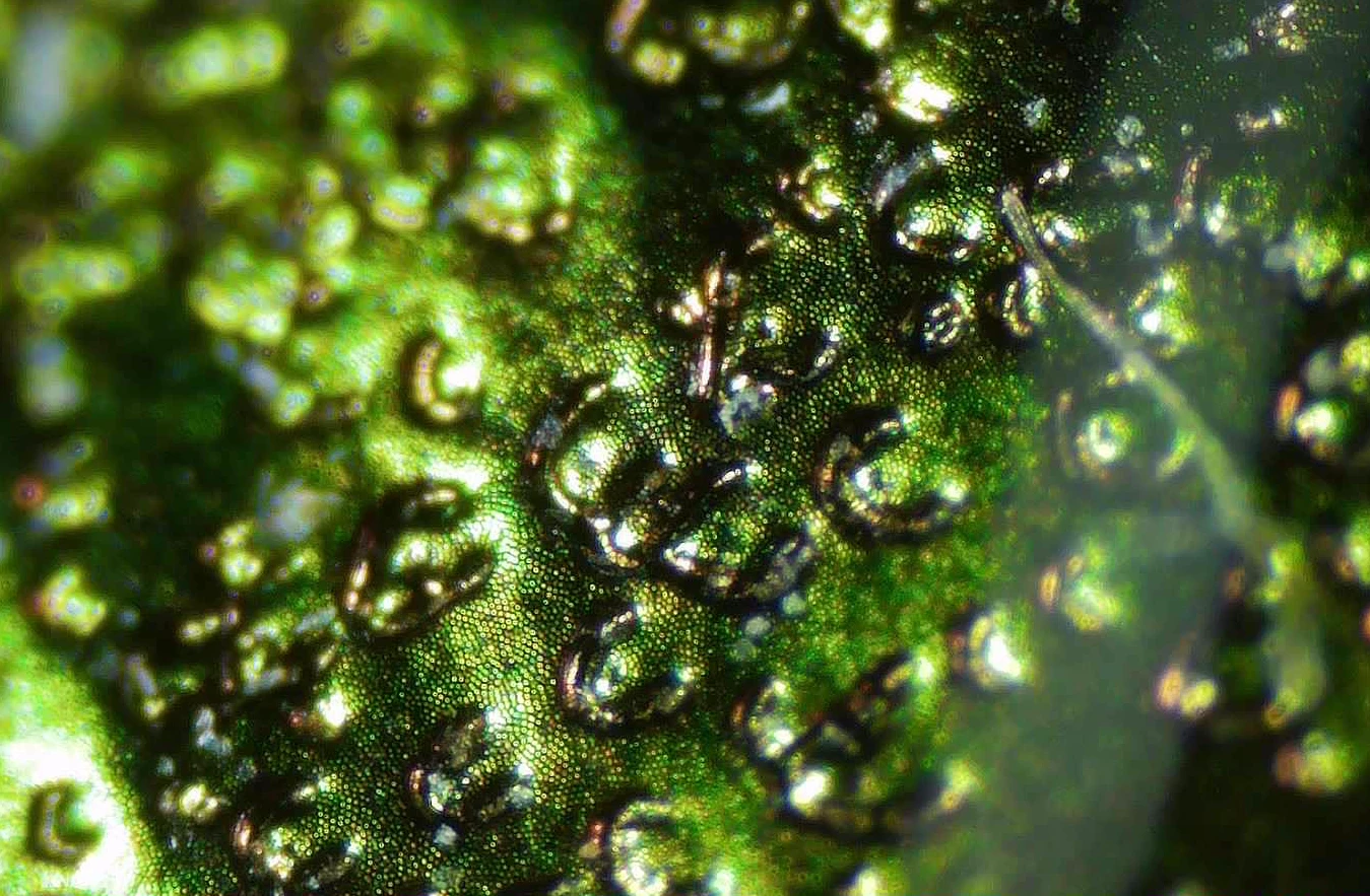

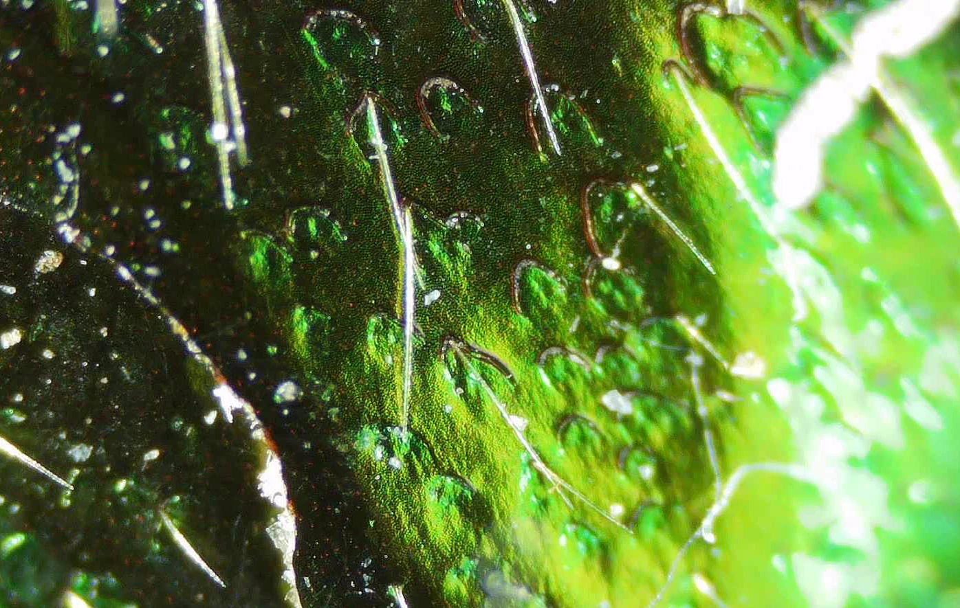

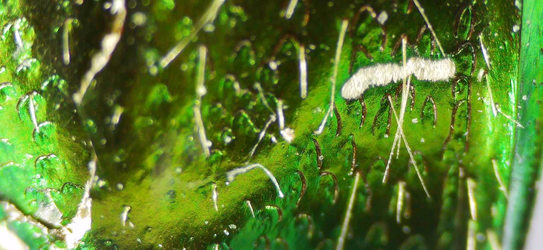

It's the iridescent surface of a rose chafer's wing under a microscope. What I'm referring to here is the smaller, mostly green spots arranged in swirly paths in between the larger, brown notches. In the first couple pictures it looks like those rows/paths are more or less solid and not particularly broken up, and you can see the flow of those paths particularly well. In the third picture it's a bit more evident that those paths are broken up and consist of smaller dots, with some space between them, while in the last picture (which is actually a different beetle) you can mainly see the spots.

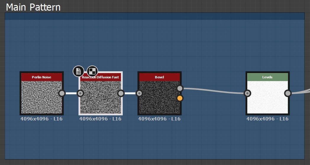

Now I'd like to ask... how would you go about creating this type of texture/mask? For the main paths/rows, I think I got a good base going:
At the selected node, it looks like this:
However, now I need to find a way to break this up into smaller spots that still follow those paths. I've tried ust blending it with different noises (with and without further nodes refining those noises), and the results are rather meh since they're not really breaking up the pattern in a very predictable, regular way. I'd need something that basically takes those white paths and turns them into an array of white dots.
