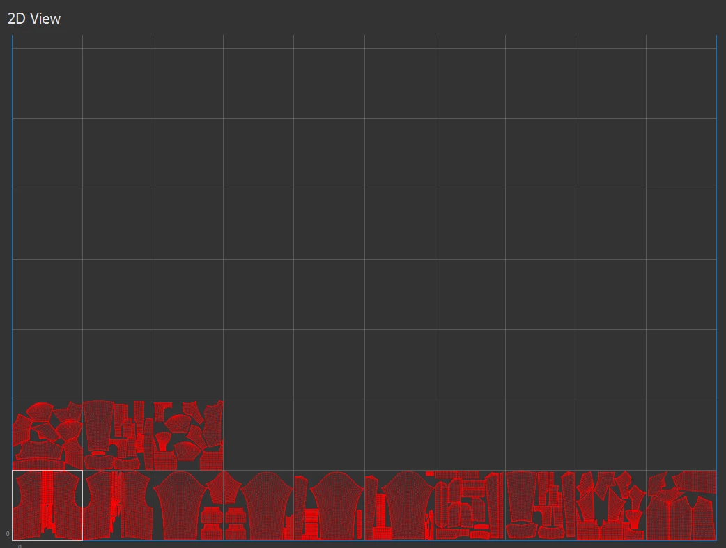

If I open the Bake Model Information window. I can see all the UDIM UV's for my 3D model. I can bake textures on all UDIM's without error. But still unable to apply the baked texture to the 3D model.

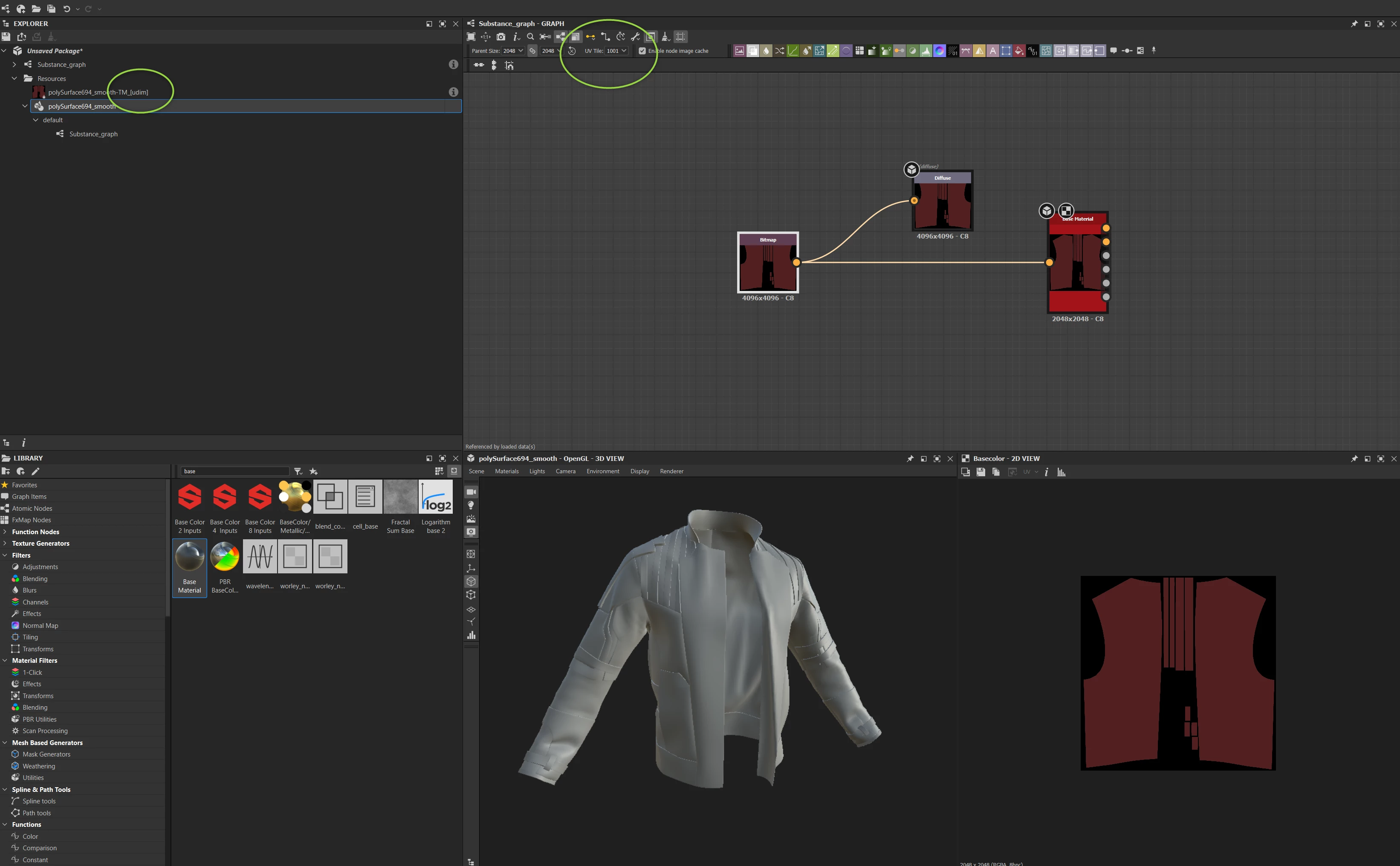

Hello @Joe_Williams4173 @Christopher3369229299jc,
My apologies, I have missed an important piece of information in my previous reply:
While it is currently not possible to view all UDIMs concurrently in the 3D View, it is still possible to visualise them one at a time:
In the Explorer, expand the tree list under the 3D scene resource and find the graphs assigned to the scene's materials. Load these graphs to visualise them on the assigned UDIMs.
A combobox appears in the toolbar with the list of UDIMs assigned to that graph, so you can switch UDIMs on the fly. Bitmap nodes will also automatically switch bitmaps when their referenced resource is a bitmap template. (This should be the case for maps baked for multiple UDIMs)
The attached video demonstrates that setup. Let me know if you require further information. This will be properly documented in the near future. (Should have been done a while ago, to be honest)
Thank you for your patience!

The Jacket is not using 1 uv tile. It is using 12 uv tiles. (UDIM)
