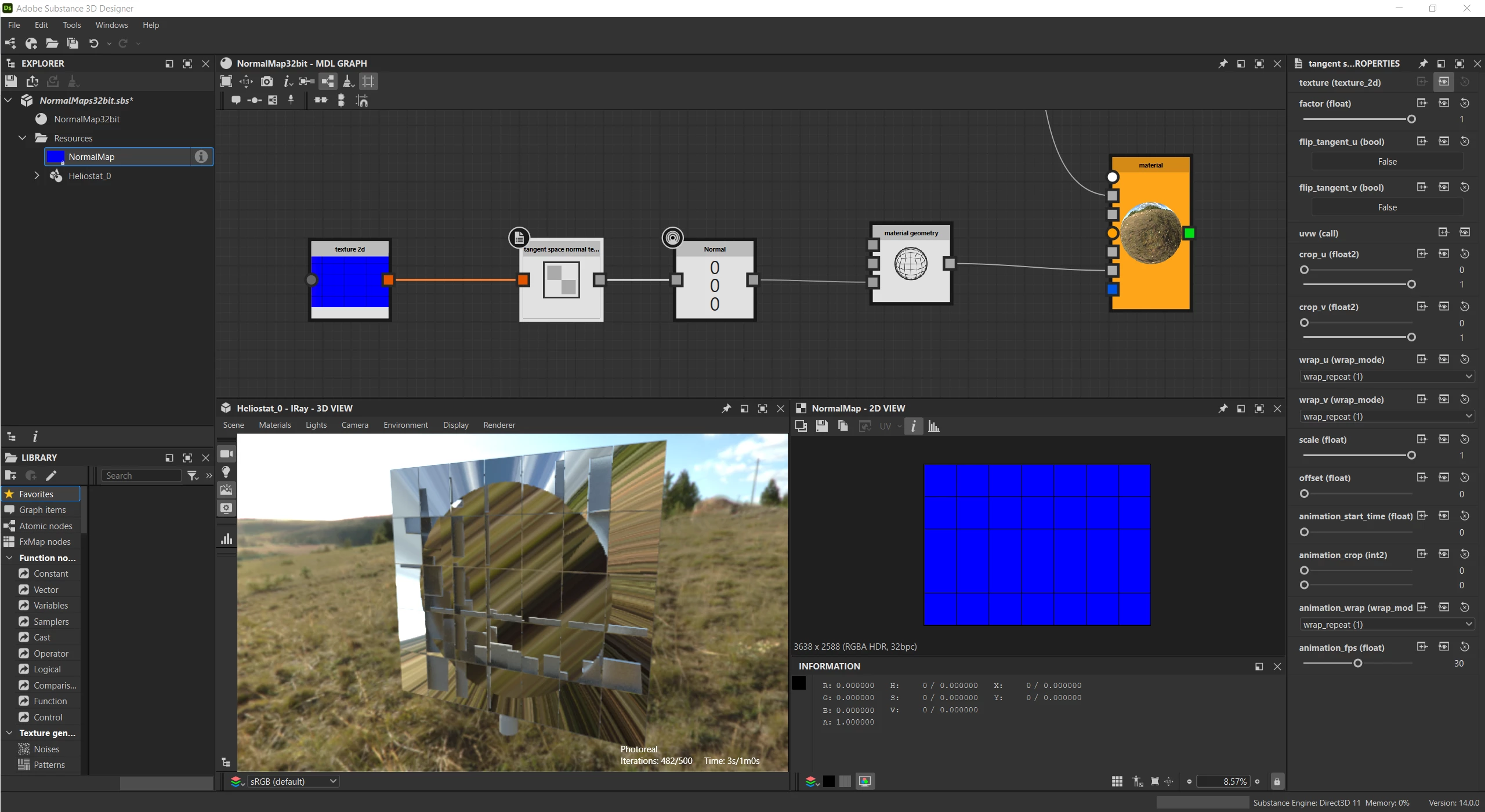

I am trying to use a 32-bit normal map (in the range [-1, 1]) to give a slight parabolic curvature to a mirror. I use tangent_space_normal_texture node to read the rgb channels as xyz normal components. The result is shown below: I should see the sceen slightly magnified.
Any suggestions?

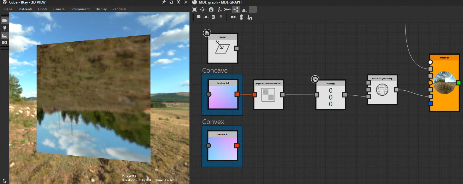

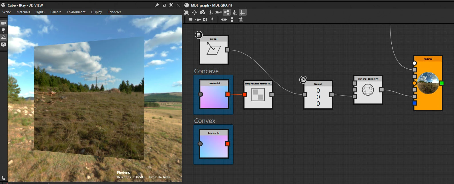

Do you need to use any negative values? You can still use 32 bit floating point to avoid any stepping while keeping values in the 0-1 range as in the examples below.
Flat normals - simple flat reflection
Concave parabaloid - magnified reflection if factor is turned down in the tangent space normal rexture node. As factor increased, the image in the 'mirror' will flip both vertically and horizontally.
Convext parabaloid (image reduced in size i.e. wider view shown in reflection):
